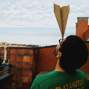

I made a wooden toy plane out of a scrap 3mm MDF sheet I had laying around basing the design on the clasic paper airplane. This was part of the initiative "Makers Care" by Steve Ramsey and there a lot of cool planes out there that you should check!

I cut fingerjoints with a small jig in the tablesaw to put together each part of the wing. There are lots of tutorials on how to make finger joints so I will not cover that here, but it is very simple. In my case I chose a finger width that would mach the thickness of 2 layers of MDF so they end up protruding like cubes, but you can choose any finger size.
I needed a bit of adjustment with a file to make it work but they went great with glue.

Once everything is dry, I sanded some edges in the disc sander. Some joints may have a thick look and we want that to resemble a paper airplane. Finally hand sanded everything with 320 grit and that was all.
