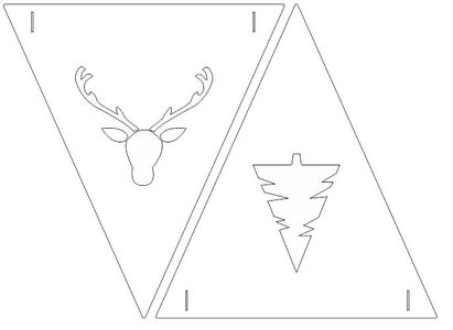

I downloaded a deer logo by Elena Rimeikaite and a tree logo by ludmil from the Noun Project. I used the outline of these designs in the creation of the wooden bunting.
The full design created with CorelDRAW is attached.
Cut out as many bunting pieces as you need - the attached file will print 14, but just copy and paste if you need more.
Sometimes the cut will not come out smoothly - in that case use your utility knife to complete the cut.
