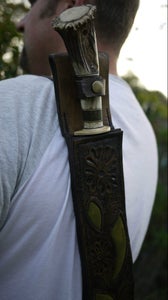

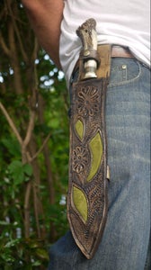

Step 15: Finished
All done!
Here's a few ways you can carry your new sheath.
Hope you enjoyed.
