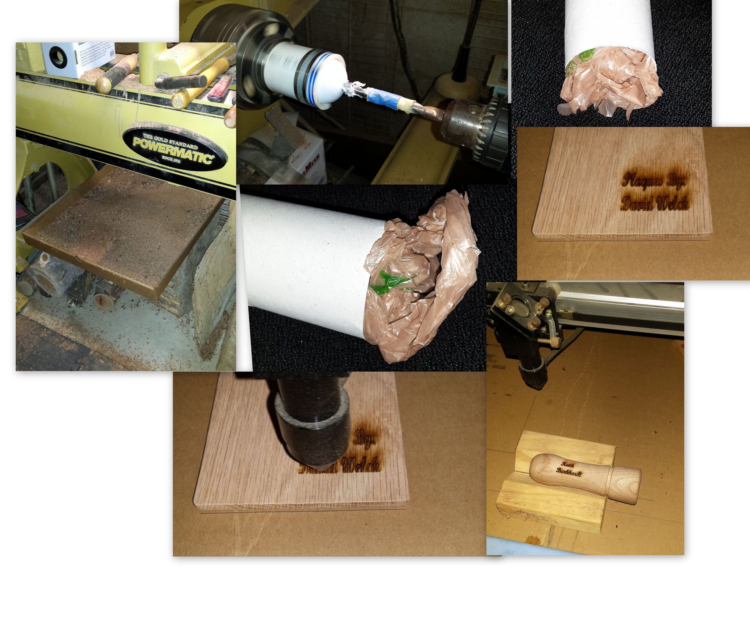

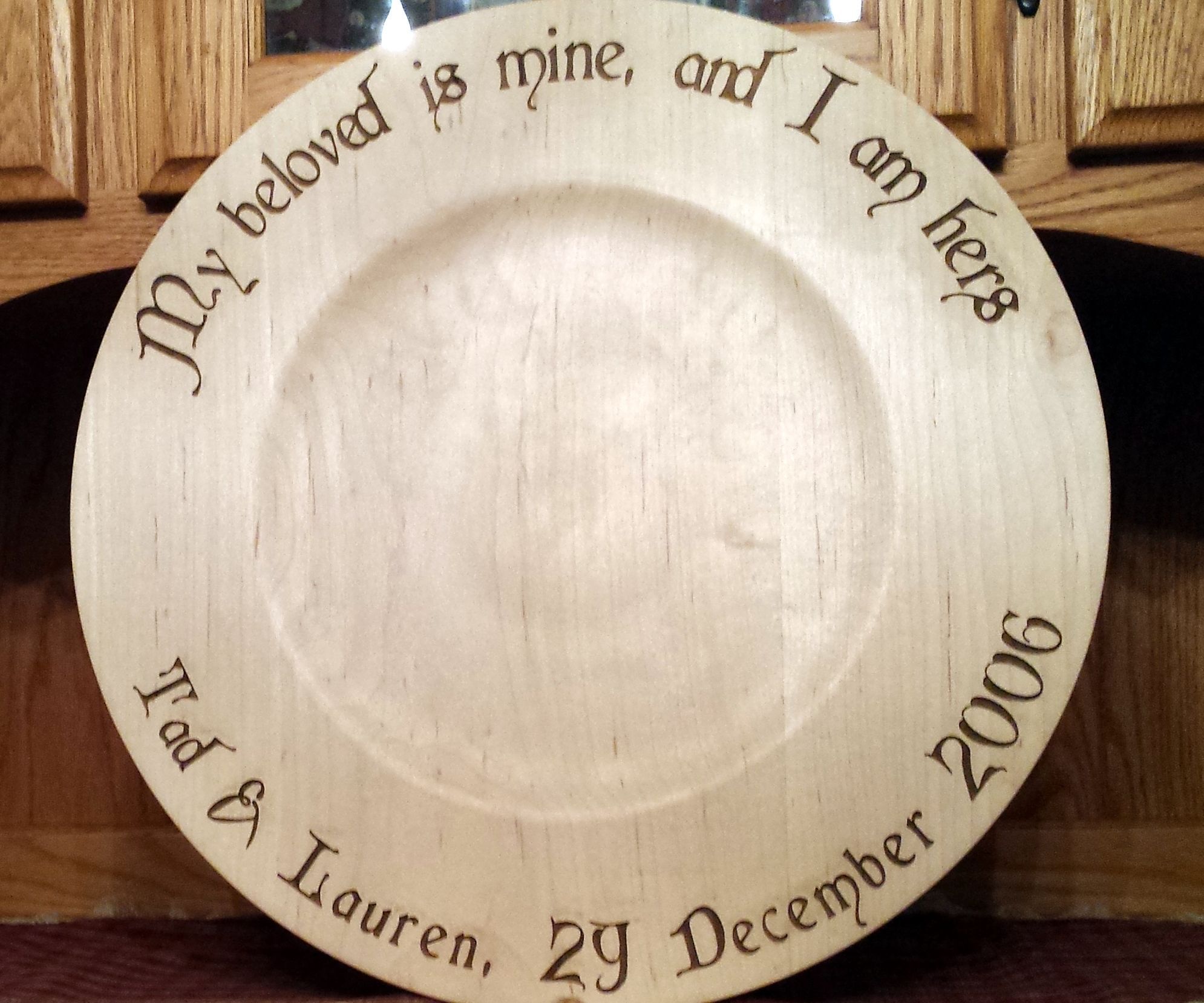

Full Spectrum Laser Contest:
The two ornaments pictured above are ones that I have made these past two years. They are laser engraved onto a thin slice of a branch from an ornamental pear tree using a very large and old Chinese water cooled laser engraver. Also pictured is several plaques I have made.
The laser engraver is too big to be brought into my house, so it stays in my garage. Last year when the temperatures reached single digits outside I learned a costly and valuable lesson -- the water in the laser tube froze cracking the glass, and the pipes in the chiller unit split under the pressure of the expanding ice. I have replaced the laser tube, however it is not as powerful so I'm not able to cut thru 1/4 inch plywood in a single pass any longer. The associated software is not all that user friendly either and the instructions are in "Chinglish" and Chinese. In addition to these ornaments I've also made a number of plaques for family and coworkers that have retired as well. So I'm putting a plug in for the laser engraver give away so I can upgrade to a much better quality one! If I win I will use it!
