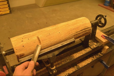

Step 2: Turn the Log to Shape
The first thing, of course, is to turn the log into perfect cylinder. Do this with a very slow speed to minimise the vibration. After that turn the speed up to get a better cut.
Then just slowly turn the log into desired shape starting with the handle.
Finish it off with different grit sandpapers and polish it with wood shavings. I really do not see the point of finishing a wooden hammer with really high grit sandpaper as the tool itself will soon have plenty of dents and imperfections anyway. I use 80, 120 and 180 grit.
After sanding use a hand saw to part it.
