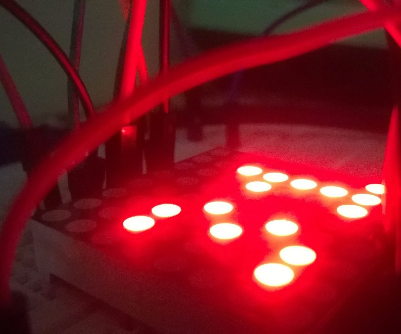

Step 6: The Circuit Board and Color Bleed
This is the heart of the project. You do it right, everything will look good.
I chose hardboard to be the base as it easy to work with (making holes and cutting), it is hard and easily available. So go and get a 9 x 9 inch hardboard. Before doing anything, check if it fits in the wooden box. If not, adjust it by filing or cutting and make it such that it is easy to remove and insert in the box.
After that is done, create a template in the Inkscape using the design of vinyl as base. Mark the places of Leds and number it. Also show the direction of data flow in the neopixel leds. As I'm using two strips, in pin number 8 & 9, I've numbered it like 8 _ _ and 9 _ , where the first numeral is the pin no and the rest is the numbering of LED. Some words like "A QUARTER" and "TWENTY FIVE" is too long, and I decided to use two leds there. Also her name should be the vivid, so I used 4 leds there. For other details you can see my template. I've attached the svg file of my template. Get it printed and check if it's perfect in size by keeping it above the vinyl you printed in transparency sheets.
Make a box of 8 x 8 inch in the hardboard with a pencil leaving equal distances from the border of hardboard in all the four sides. Remember the hardboard is 9 x 9 inch and the template is 8 x 8 inch. Stick the template in hardboard using paper glue in the box you drawn.
Cut the Led strips individually and use the double sided tape provided in it's back to stick it in the positions of Leds in your template. I only had 30 leds in the strips but I needed 4 more. Also I had 20 same kind leds laying around. So I used 4 of them, made my own module by adding capacitors and sticking it in a cardboard using hot glue and use it in the word "Sneha".
After all Leds are stuck, make 6 holes beside every led, 3 on left side and 3 on right side. I used a hammer and a nail of appropriate size to make holes. Make sure the holes are individual from each other, otherwise wires will get shorted after soldering. After that get your 0.75 sq mm solid wire, strip it's ends and pass it through holes and solder it to the leds. Don't forget leds are flipped in every alternate row, give special attention to the data flow direction arrow while soldering. Keep all the wiring in the back side of the hardboard because we have to add cardboard afterwards to avoid color bleeding.
Speaking of color bleeding, I cut the white cardboard with a width of 25 mm after measuring the length required. I used hot glue to make it stand still, and it works very great. Places where I can't use hot glue, I used paper glue, but it takes over a night to dry. So, choose wisely.
Solution for too narrow places for a Led to fit in:
For letters like "I" and the heart which are too narrow to fit a led, I stick the led there with only led on top of the letter and other excess parts outside of it. I'll stick the cardboard above the excess parts. It makes no issue. Still there was a problem while sticking leds in the "heart". There was one more led adjacent to it, due to which my idea was not applicable there. To solve it, I decided to make that led very last so that I can also cut the right part of the led as I will not have to transfer any more data (as there are no Leds after it). Refer the picture I have added.
For three letter words like "ONE" or "TWO" I cut a slit, bent the PCB of led and passed it through in the back of the hardboard. That's weird I know, but it works. That was an idea of a friend of mine. But, don't do it everywhere, only places where its necessary.
