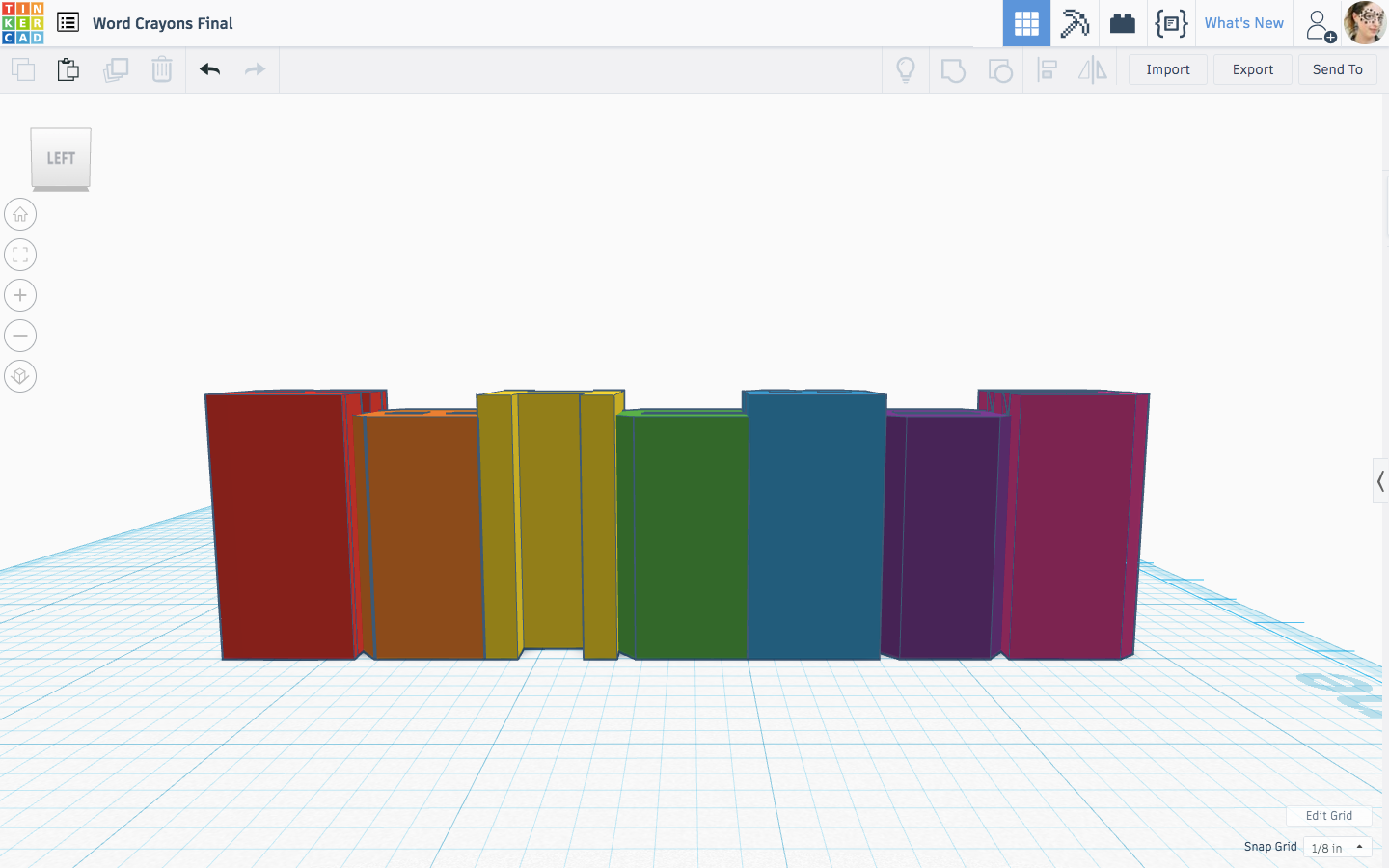

I will start by stating I knew I wanted the crayons to end up being .625" wide by .625" deep by length determined by letters that are .625" high.
First order of business is finding a font to make my molds with.
I tried the one in Tinkercad and (at least at the time) the font wasn't going to work with what I wanted. I wanted something really boxy. After looking at what was already on my computer and looking on free font sites, I found Pro Lamina. I ended up having to do editing on the font to get it the way I wanted it, but it was a great font to get me going. Some edits I made included: making all the letters square, giving the "I" lines on the top and bottom, and making the middle of the W reach the top. This was just for rainbow and edits were made on a letter by letter basis. (By the time I reached the end of this project, those edits may not have been necessary, but I'm still happy with them.)

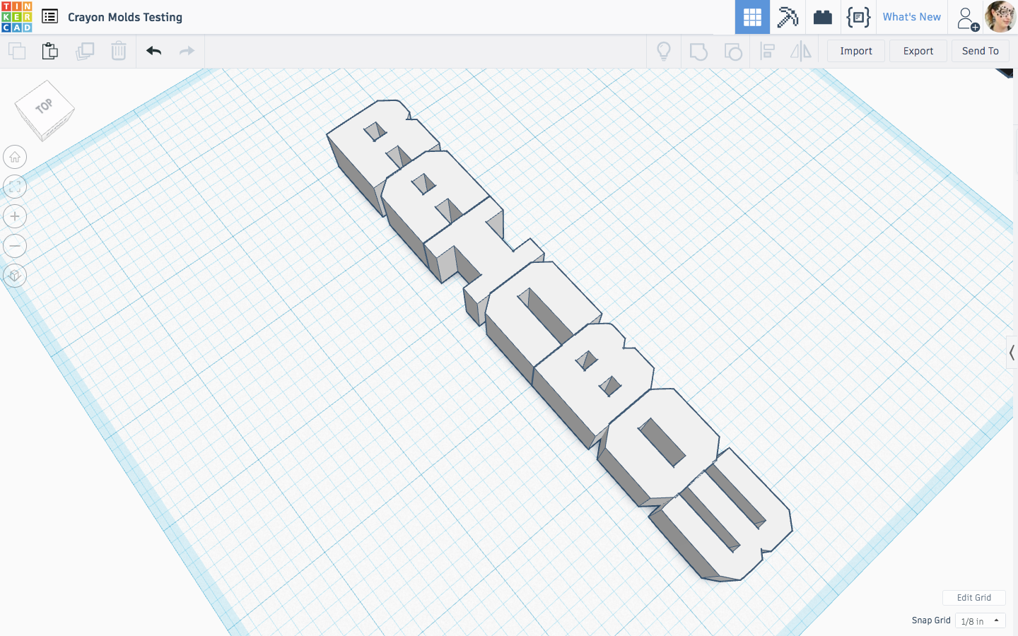

Now that I had the font, I needed to get the individual letters into Tinkercad. I used Silhouette Studio because it's a program I'm very familiar with. I took each letter individually and did any minor alterations I wanted. When it was ready I exported it as a PNG, used an online site to make it an SVG, then brought it into Tinkercad.

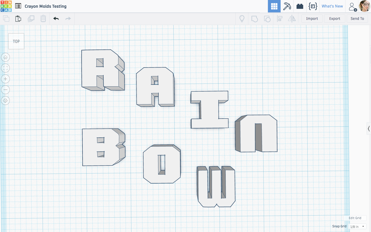

To get myself started, I got all the letters for RAINBOW and started arranging them to get an idea of what I was working with. After doing some initial setups, it seem liked stacking the letters was going to make for the best setup.
Looking at it, I wanted the letters to stand out more, so using the same method Jon-A-Tron used when making a name keychain, I decided every other letter would stand up a bit more than the one next to it. For every word, it would start with a raised letter, then the second would be shorter, third higher, etc. I made the letters .1" different in height.

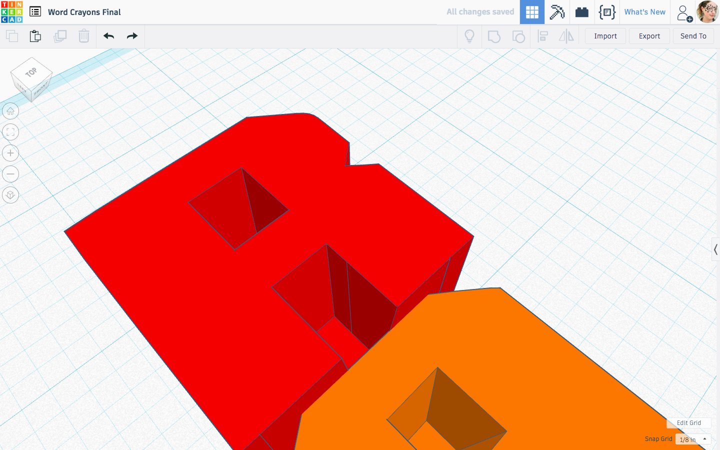

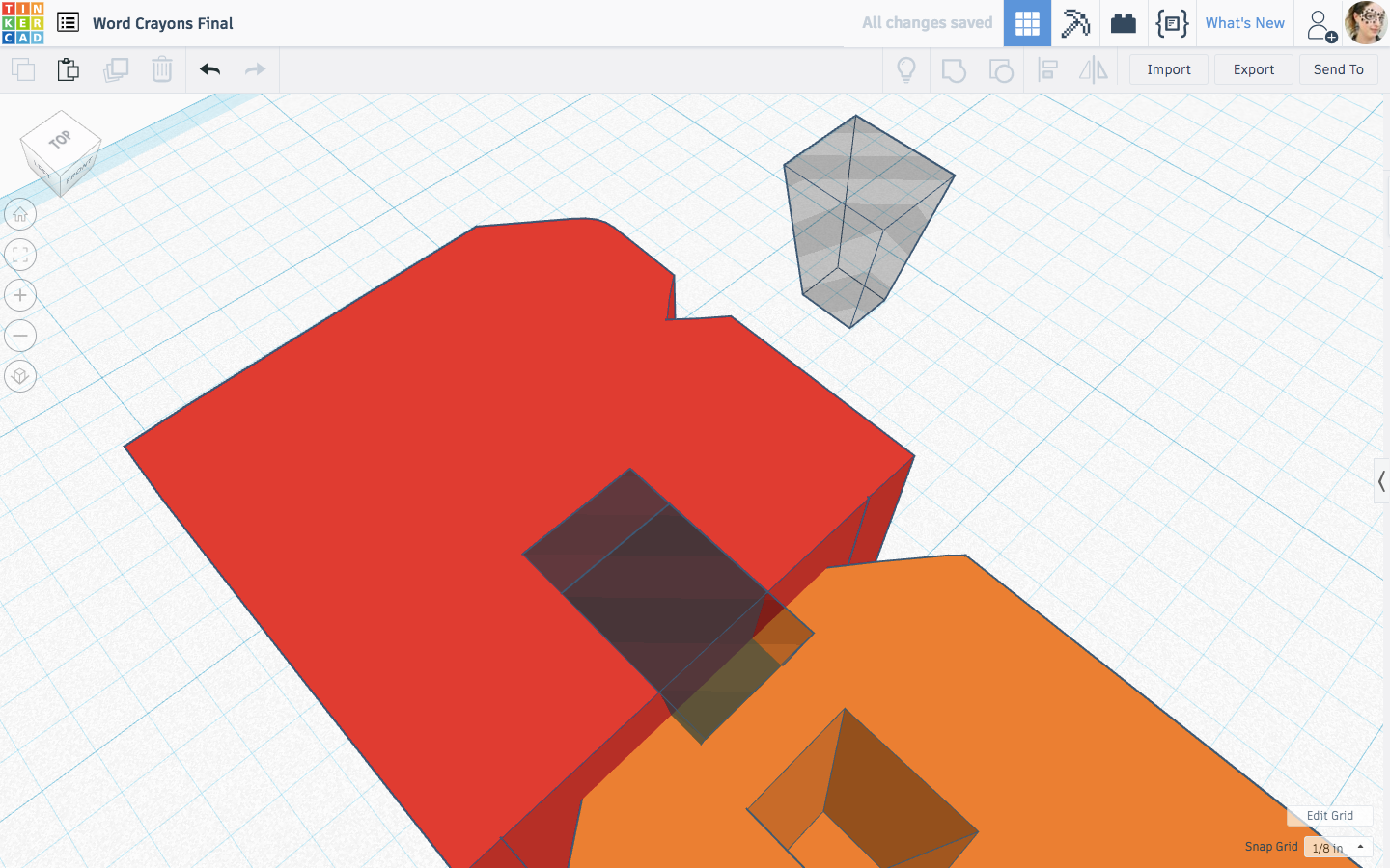

(After tests) I decided the "details" of the letters would only go down about 1/4" deep so they wouldn't go all the way through. As much as I wanted the holes in the letters to go all the way through, it just wasn't going to work out. I also decided the holes should go in at a slight angle to make it easier for the 3D print (and eventually the crayon) to come out of the mold. To make the holes have an angle, I created a cutout separately that went in on the bottom (instead of just going straight down) just using basic shapes (second image below). I filled in the hole in the letter so that there was no hole at all, and lined up my new hole cut out where the old holes used to be (third image below). My cutouts were a little messy but as long as they sliced right, I left them.

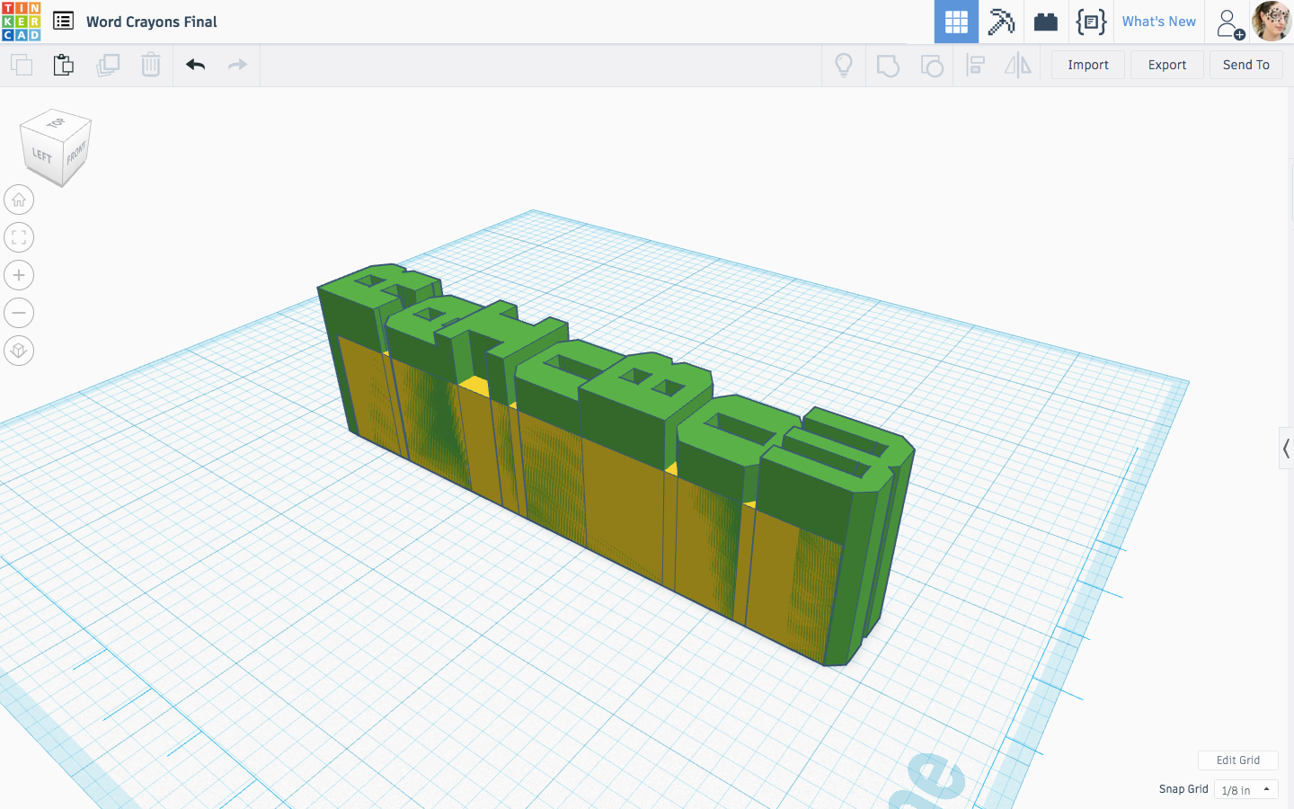

At this point well change the full size of the letter. We need to do this in order to fill the mold with crayons as they will melt down to the size we want. (After tests) I decided to full depth of the highest letter would be 1 1/4".
Lastly, I needed to overlap some of the letters because for some reason they didn't import perfectly. So what I would do is group the letters, export, bring into slicer, and make sure it acted like the letters were attached to each other. Sometimes they would have a slight slight gap making the infill funny. If that happened I noted where the mistakes were and went back to Tinkercad to make changes.
I repeated this for all the words until I had all the colors of the rainbow! (I did PURPLE instead of doing either Indigo or Violet. I grew up with purple so I just did purple.)
