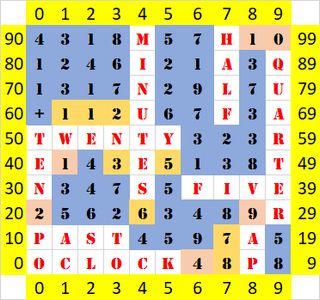

This is a hybrid clock incorporating the elements of a word clock and a digital clock.
That is used to display the time in 12 hour mode.
The display grid consists of 59 numbers, 40 letters and 1 symbol (+), backlit with 100 addressable RGB LED's on a 10 x 10 grid all controlled by a Microbit.
The numbers enable time combinations that exclude the five minute time intervals whilst the letters display the five minute intervals. In addition to the meridiem's represented by A for AM and P for PM.
The layout is such that the numbers may appear haphazard therefore to clarify its type, colour coding is applied.
Subject to user preference or vision colour perception other colours may be used.
The hours are displayed in green the minutes are displayed in red and the meridiem's in blue.
Example times.
14:00 becomes 2 OCLOCK P
14:10 becomes TEN PAST 2 P
03:45 becomes QUARTER TO 4 A
07:09 becomes 7 9 A
20:19 becomes 8 19 P

The information to be displayed determined how many characters were required.
I laid out the characters for the display in Excel first.
A requirement for the display was that the characters should be of a stencil type.
This would require connected negative space to prevent the centres of enclosed characters falling out.
Examples Q,R,O, P, A, D, B, 4, 6, 8, 9, 0
I found a suitable stencil type font: Aero Matics Stencil Font this is a free font from 1001freefonts.com
