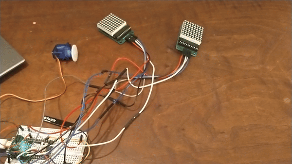

Step 1: Wiring
Depending on your LED matrix, you may need to solder wires to the matrix to connect to the Argon. If your matrix has the little metal things then you can just use jumper wires. Your Argon needs to be on a breadboard, and then you can place all wires next to their proper ports on the Argon. Connect the Argon to your computer power supply via the USB cord.

void setup() {
    Serial.begin(9600);
    led = new LEDMatrix(1, 1, A1, A2, A3);
    led->addMatrix(0, 0, 270);
    Particle.subscribe("hook-response/scrape/0", myHandler);
    Particle.publish("scrape");
