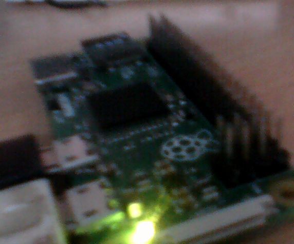

Introduction: Wordpress in a Pocket
The Raspberry Pi Zero is the smallest computer in the Raspberry Pi family.
Easy to slip in your pocket, the Pi Zero can be used as a Wordpress Server.
I chose Wordpress because it is the instant solution for creating a powerful website easily.

1 Raspberry Pi Zero or Zero W connected to the Internet. Make sure you are running a Debian-based operating system such as Raspbian or DietPi. Ubuntu is not supported on the Pi Zero, as Ubuntu can only run on an ARMv7 or higher architecture. Here I have setup the Pi Zero via USB Ethernet. You can also o this via Wi-Fi.
Make sure SSH is enabled.

Power up the Zero and connect it to the Internet using Wifi or USB Ethernet.
