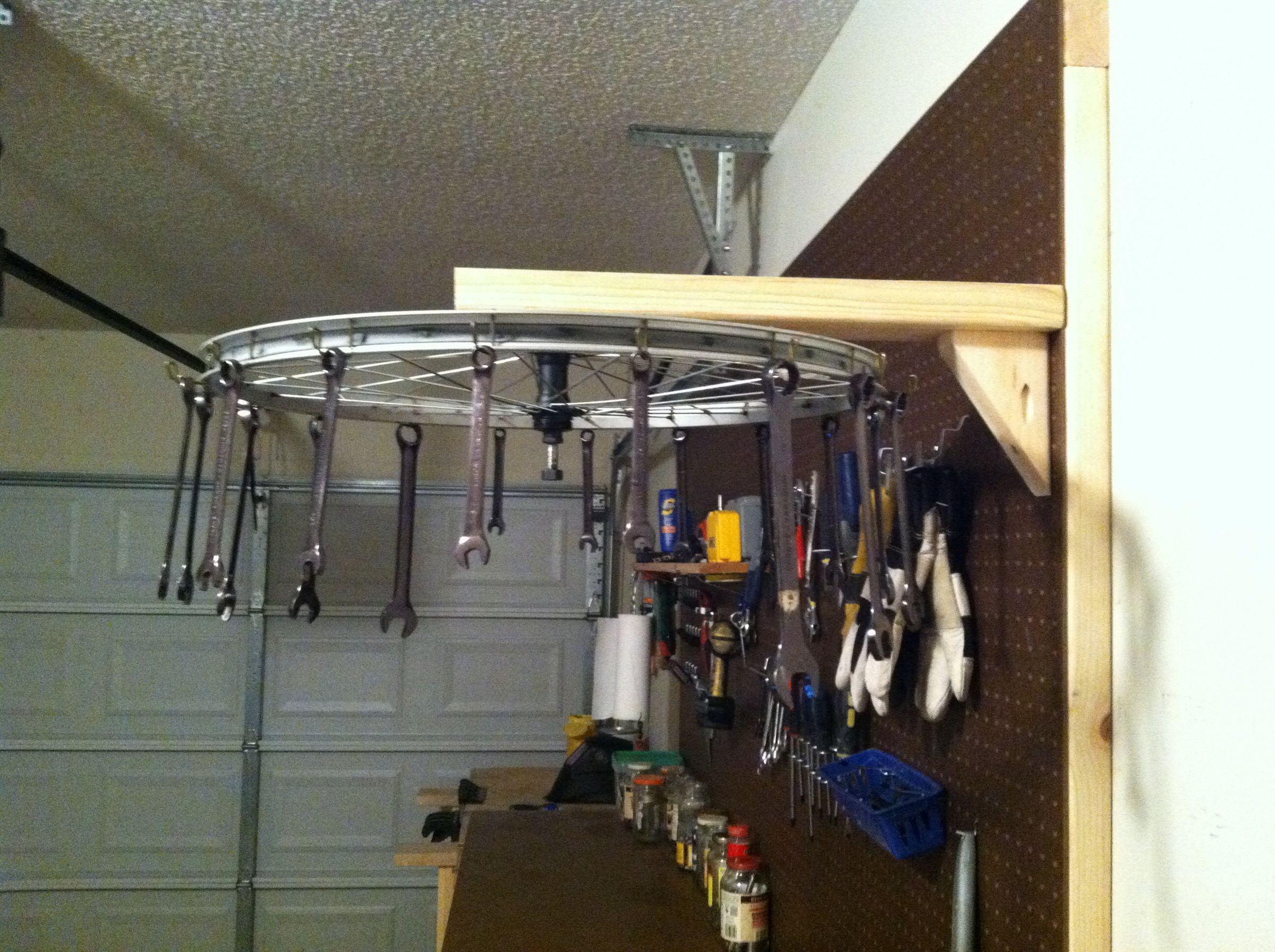

When I got the MDF board, I had the store cut it in 2 long ways. I put one half on top of the work bench. The other half I notched out so that it would fit around the legs and put on the bottom of the bench. Once they where in place, I screwed them down.
Step 7:
As most of you know, it doesn't take much to mess up a MDF board. So I glued some hard board to the top of the MDF and clamped it down until it dried.
Step 8: Peg Board
The last step is putting up a frame for the peg board and screw the peg board into the frame. All done!!!
