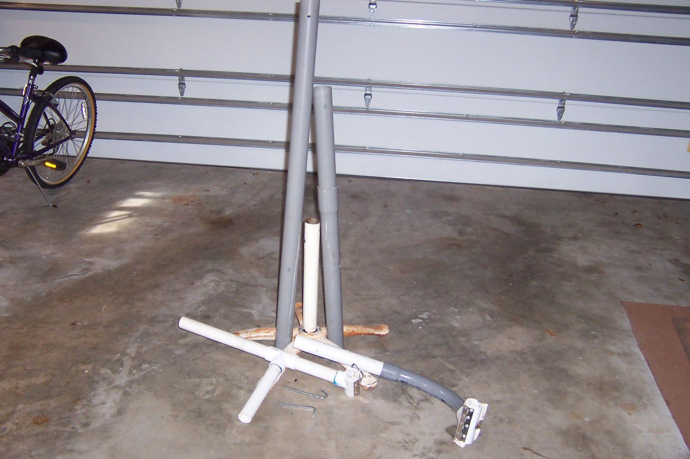

Step 5: This Is Original Mobile Repair Stand
note the call out for clamp & ell.
Step 6: This Is Detail on Original Stand
Note details on fabrication of clamp & ell.
