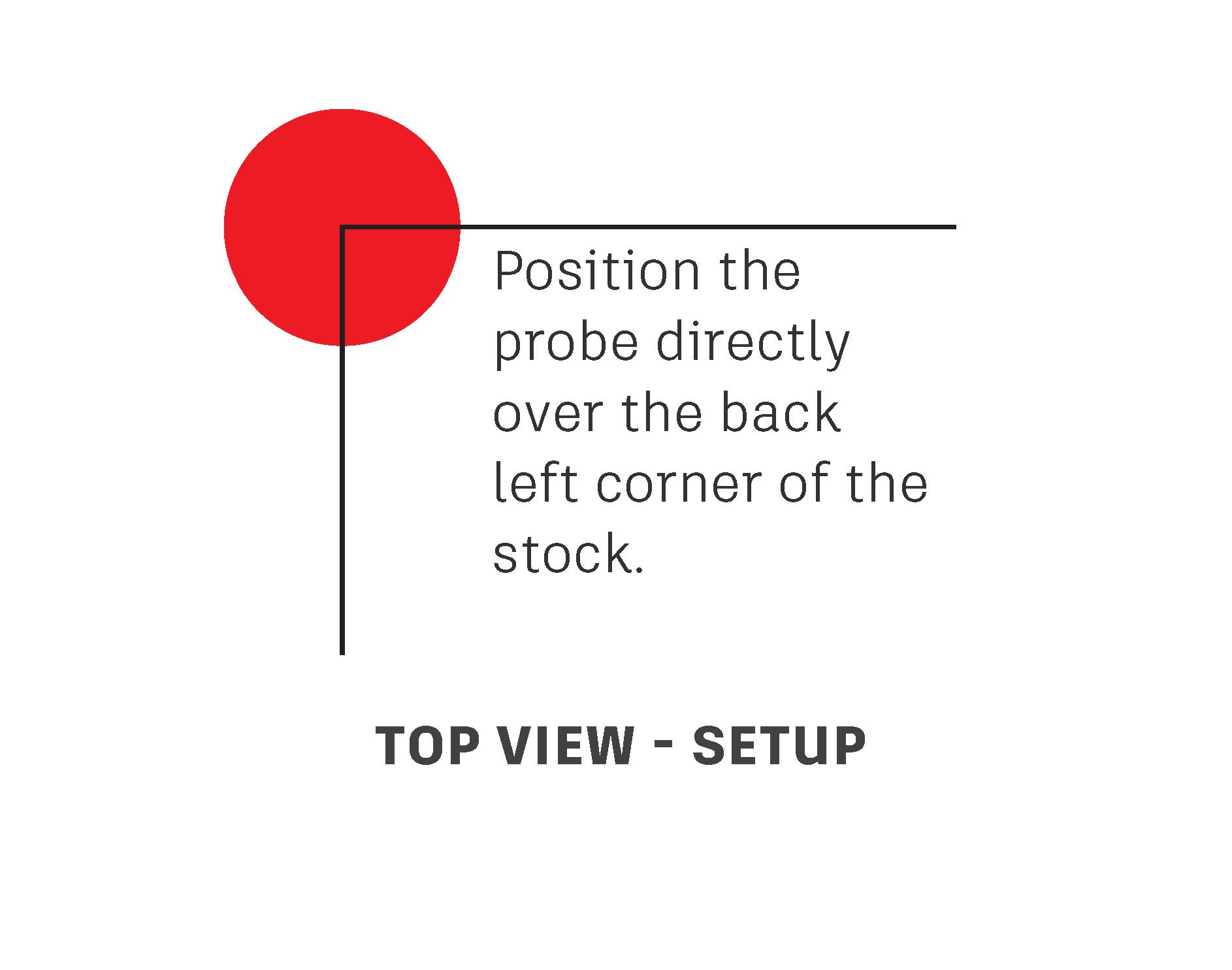

Step 1: Finding X and Y
You have set your Z work coordinate; now set X & Y.

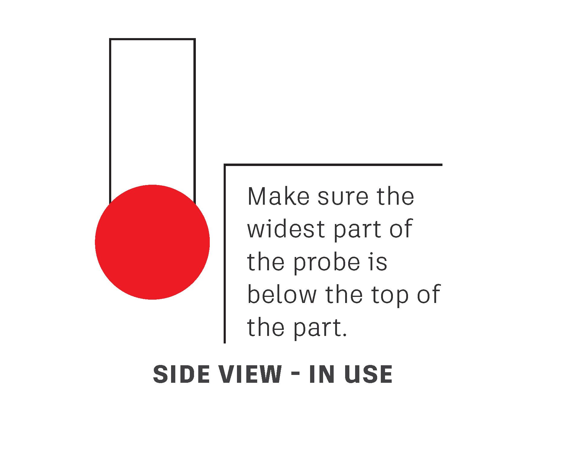

- Jog the probe over the back left corner of the stock.
- See image
- Make the Work Zero Offset table the active window.
- Navigate to the Probing Options page.
- You want to probe the back side and left edge of the material.
- Enter 9 and press WRITE/ENTER for Outer Corner.
- Navigate right to edit the Outer Corner value.
- Enter 4 and press WRITE/ENTER.
- This will select the back left corner.
- Enter -0.4 and press WRITE/ENTER for incremental Z, X & Y.
- PRESS CYCLE START.
- Check that the full diameter of the probe contacts the material. (see image)
- Navigate left and check that the G54 coordinates have changed. Compare them to your photo.
