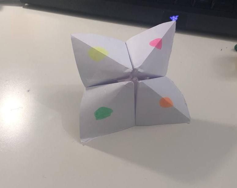

Introduction: Work From Home - CPX
Recently I have begun working from home everyday so I decided to use my Circuit Playground Express for automating some of my daily tasks.
The following project will instruct how to create a simple Work From Home helper using a Circuit Playground Express Arduino board with an ESP8266 wifi board.
The functionalities are -
1) Registering work hours using the CPX light sensor.
2) Setting a status on 'Slack' for times you are available\unavailable using the proximity sensor.
3) Setting Reminders for tasks such as getting up and taking a walk (for your health).
4) Setting reminder for events\meetings and defining a 'focus mode'.
The functionalities are easily configurable and can be extended for further usage.

Usage
1) Connect the CPX to the batteries and place it near light sources that can be turned on/off according to work hours.
2) Go to Integromat.com and make sure all the defined scenarios are turned on.
3) In order to adjust the proximity go to Blynk dashboard and use the slide to change the value. To check it see if it turns green/red according to your proximity to it.
4) Toggle focus mode setting and change your available/unavailable using the Blynk dashboard.
When the lights are off the CPX leds should also be off. When you turn the lights on the leds will light in green or red if you are away from you work station.
When the leds are on it means that your workday has begun, and new meeting alerts \ walking alerts will start arriving.
