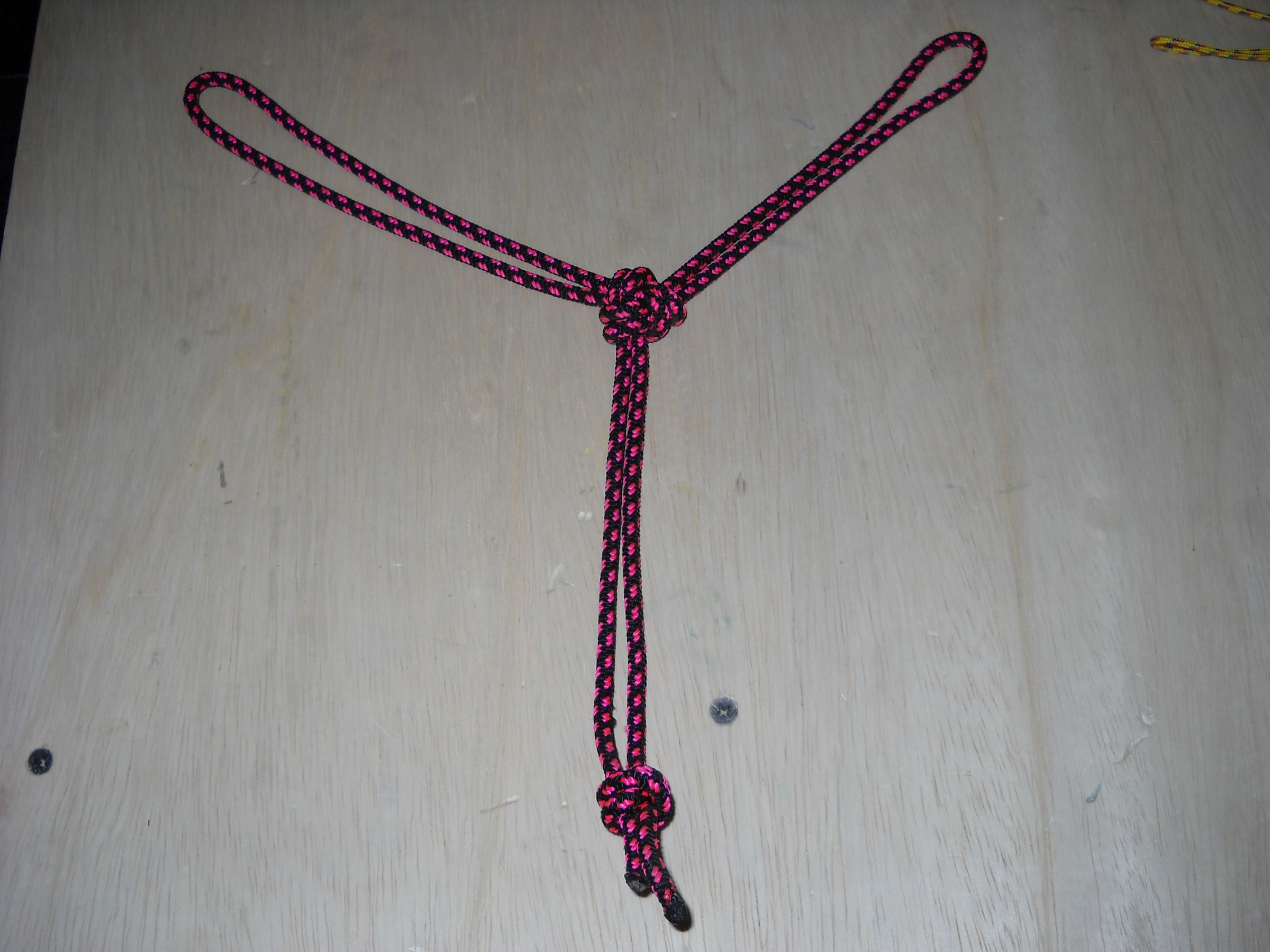

Paracord and mule tape 3:1 pulley set-ups hold the bench top down to the frame.
