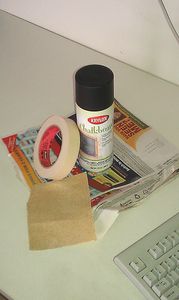

Step 1: Materials/Tools
Materials
* Chalkboard Paint - I used Krylon black chalkboard spray and it works really well.
* Chalk - White, colored, both, whatever floats your boat, just not clay based.
* Eraser - Felt ones work the best.
* Newspaper - For blocking over-spray.
Tools
* Masking Tape - For masking of course.
* Sand Paper - For prepping the surface, finer grits such as 200 probably work best. I used 100 and it was alright but I wouldn't go much courser as it could give you an uneven surface.
Tools

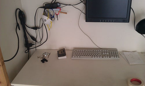

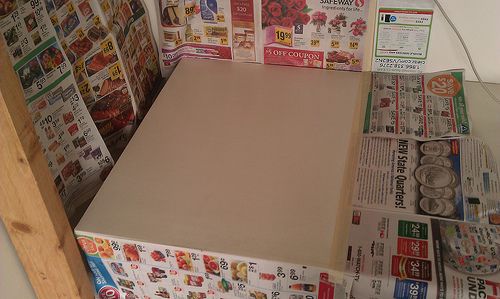

Step 2: Prep the Surface for Paint
For a normal, painted wood surface start by sanding the area to be painted. You don't need remove the paint just any surface imperfections and grime. This is especially important for smooth surfaces to help the paint stick properly.
After sanding, wipe the surface clean of any dust.
Next, mask off the intended area using the newspaper to keep over-spray from getting on the rest of your workbench.

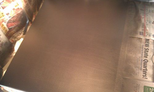

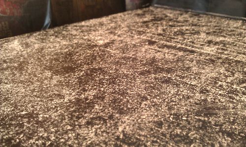

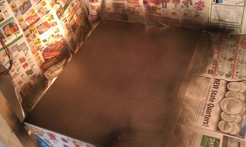

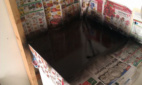

Step 3: Paint
You will need at least 2 coats of paint to get a nice even surface.
When painting try to work in only the one direction (horizontal or vertical) and then come back in the other direction. Avoid painting in 'spots' or only one area at a time as much as possible. You are not only worried about the appearance of your paint job but the surface as well so if you apply the paint unevenly it will have a negative effect on how easily you can write on the surface.
Standard painting rules apply: Let the first coat dry before applying the second, don't paint in high humidity, ventilate, don't mess with the surface for at least 24 hours after the final coat is applied (or longer depending on conditions).

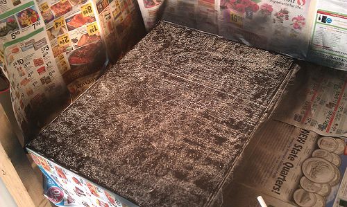

Step 4: Prep the Surface for Use
Once dry it is recommended that you lightly rub the edge of a piece of chalk over the entire surface and then erase before use.

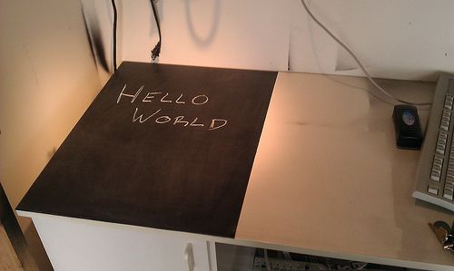

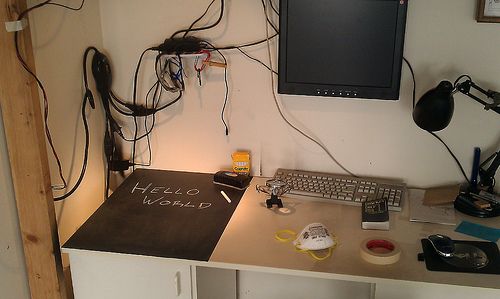

Step 5: Write Away!
Now all your notes, diagrams, part lists, etc. can be kept in one place that doesn't take up any workspace. If the surface gets scratched up or stops erasing (try a damp cloth first) you can simply apply a fresh coat of paint.
