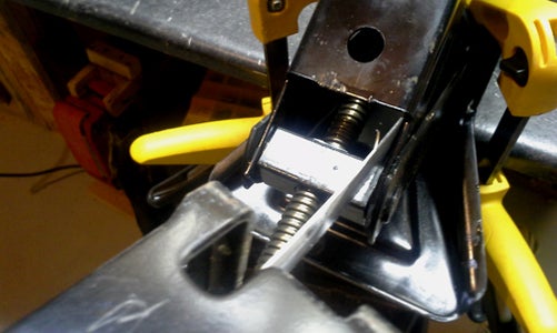

Cut the threaded rod out of the scissor jack. Save one of the tapped cross bars that are on the threaded rod.

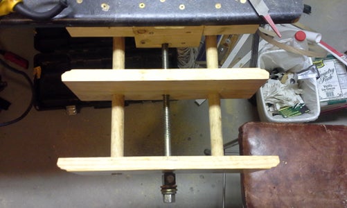

Pair up the drawer fronts. Locate the positions you want the dowel slide to through. Locate where you want the rod to go through. Drill through the top face far enough with your spade bit to locate one the bottom drawer face. Then drill through the bottom part way from both sides to leave clean holes with no splintering.
Make sure the holes on the front drawer face are as tight on the dowels as possible. I had to sand the dowels down just a hair in order to hammer them on. I bored out the holes that the dowels would slide through a bit so it was snug but it could slide.
Cut a slot in the end of your dowels to receive wedges and hold everything tight later. I cut the slot all the way to the sanded shoulder that the drawer face will be snug up against. This was about 2 inches.

Step 5: Attach Face and Handle
Slide the drawer face over the dowels to the sanded shoulders of the dowel.
Glue the hole and dowel slot
hammer dowel in close vise to to dry in that position
the exposed end of the threaded rod is a 3/4" hex head. I have a my grandfather's Tommy bar as mentioned or I have one of his old 3/4" sockets that I drive with my drill. I don't think I'll do that often. I don't want to crush anything in the vise or break the vise itself.
