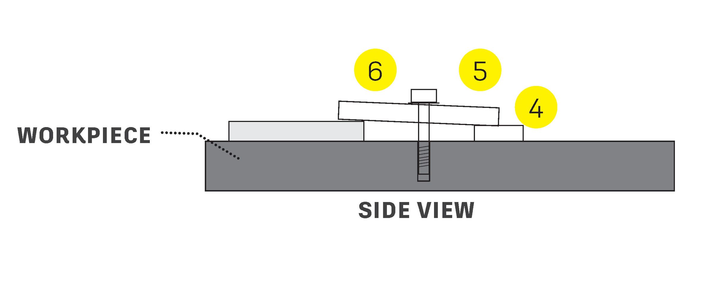

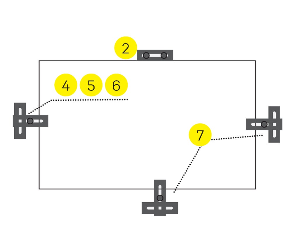

Partial Sheet Workholding
The table has a grid of over 400 holes. Each hole has a threaded metal insert that nylon bolts can be screwed into. The nylon bolts secure the hold down blocks that hold your workpiece.
- Blow out the insert with compressed air.
- Place a hold down the block at on the table, at the back of the workpiece.
- Place the long edge of the block against the workpiece.
- Screw in two bolts, using washers.
- Hand tighten the bolts.
- Use a wrench to tighten an additional 1/4 turn.
- Do not overtighten.
- Place a block a few inches from your workpiece.
- Place a second block on the first, with one end on top of your workpiece.
- Attach them with a nylon bolt.
- Add a minimum of two more hold downs.
