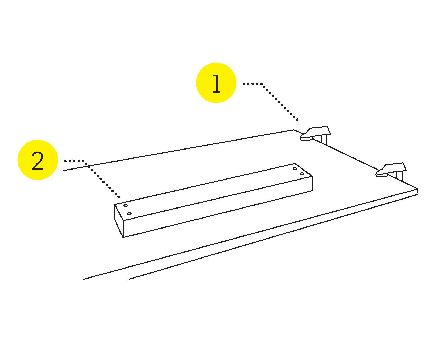

Spoiler Board & Clamps
- Clamp a spoiler board to the table.
- Screw your material to the spoiler board. Use a minimum of 4 screws, and more for large projects.
Make sure that the tool will not collide with a clamp or screw.
- Brass screws will not damage the tooling in the case of a collision.

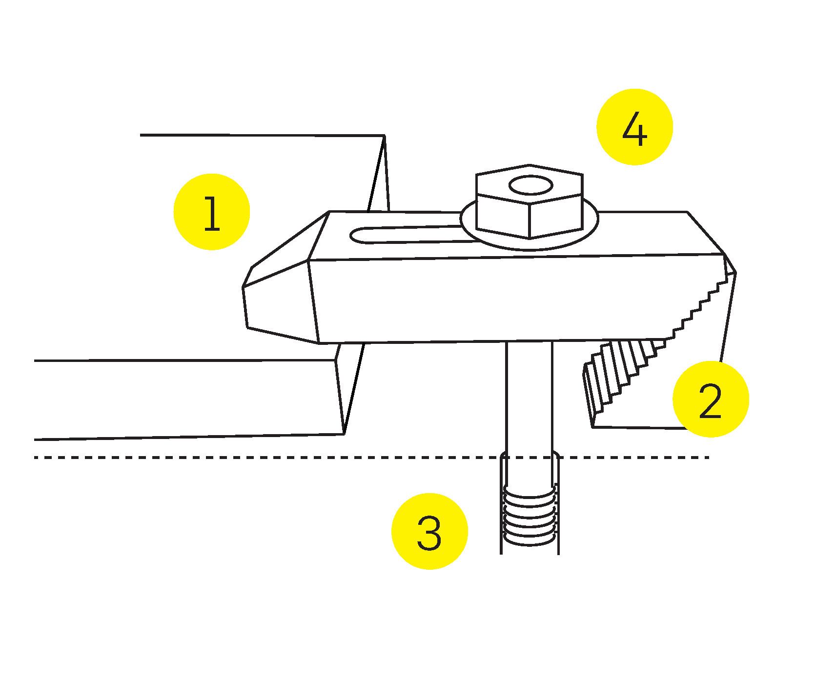

Threaded Inserts & Step Clamps
- Hold the work with a step clamp.
- The clamp should be level.
- Support the end of the clamp with a step block.
- Insert a threaded stud through the clamp into the table insert.
- Tighten a nut on top of the clamp.
- Use a minimum of 4 clamps, and more for large projects.
Make sure that the tool will not collide with a clamp.
