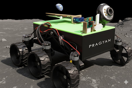

Introduction: Working Model of Chandrayaan-3 Pragyan Lunar Rover
The Pragyan rover is the six-wheeled lunar rover from India’s Chandrayaan-3 mission, designed to traverse the Moon’s surface with a rocker-bogie suspension system. In this project, we’ll build a working miniature model of the Pragyan rover. This DIY rover will be able to drive around, demonstrating the same six-wheel drive and suspension concept that allows the real Pragyan to handle rough terrain. Building this model is a fun way to celebrate the Chandrayaan-3 mission and learn about robotics and engineering. By following this guide, you will learn how to construct the chassis, assemble a rocker-bogie mechanism, integrate motors and electronics, and remotely control your own small-scale rover. The rover’s small size and simple design make it affordable, easy to build, and easy to operate, even for beginners.

Step 1: Build the Chassis Frame
The first step is to prepare the rover’s chassis, which is the main body that will hold the electronics and serve as the attachment point for the suspension. If you have a 3D-printed chassis design (for example, from the video’s provided files), print it out and skip to mounting components. Otherwise, you can improvise: for example, use a small plastic lunch box or a sturdy rectangular container as the rover body. Ensure the chassis is big enough to fit your Arduino, battery, and motor driver inside, and long enough to space out the wheel pairs (the real Pragyan rover is about 90 cm long, but your model could be around 30 cm long – use a size that fits your components).
If using a custom box or plate, mark and drill holes or cut notches where the suspension arms and motors will attach. Typically, you’ll need:
  1. Front/Rear Suspension Mounts: Two points on each side of the chassis to attach the rocker-bogie arms (one toward the front, one toward the rear). These can be bolts, brackets or printed pegs that the arms will pivot on. Make sure these points are aligned and at the same height on both sides.
  2. Electronics Mounting: Drill small holes or use standoffs inside the chassis to mount the Arduino board and motor driver securely. You can also use adhesive Velcro or double-sided tape to stick down the boards and battery for now.
  3. Access: If your chassis is enclosed (like a box), consider cutting an opening or door to access the inside, so you can adjust wiring or remove the battery to charge.
Tip: Keep the chassis light but sturdy. If using a thin plastic box, reinforce areas where motors or arms attach (for example, add an extra piece of plastic or wood inside as backing for a screw). A lighter rover will drive easier, but it should be strong enough not to flex too much when the suspension moves.
Step 2: Assemble the Rocker-Bogie Suspension
The rocker-bogie mechanism is what gives the rover its ability to climb over uneven terrain with all wheels on the ground. It consists of two “rocker” arms (one on each side of the rover) and two smaller “bogie” links on each side connecting the wheels. Here’s how to build it:
  1. Prepare the Arms: If you have 3D-printed suspension arms and links (often provided in the project files), gather those pieces. Otherwise, you can make the arms from PVC pipe or thick cardboard
  2. You will need:
  3. Rockers: Two long arms (left and right) that will connect the front wheel assembly to the rear wheel. Each rocker will pivot roughly at the middle (where it attaches to the chassis mount).
  4. Bogie links: Four shorter link pieces (two per side) that connect the front wheel to the middle wheel on each side. In a classic rocker-bogie, the bogie is hinged to the rocker near the front wheel.
  5. Attach Bogie to Rocker: On each side, attach a bogie link to the front end of the rocker arm using a bolt or axle that allows it to pivot. This joint should be snug but freely rotating. The other end of the bogie will later hold the front and middle wheel motors. For now, ensure the rocker and bogie can swing relative to each other. Repeat for both sides.
  6. Mount Rockers to Chassis: Now attach each rocker arm to the chassis at the pivot point you prepared (toward the middle of the arm). This is the main suspension hinge where the arm rocks. Use a bolt or shaft through the chassis wall so the rocker can rotate up and down. It’s important that the left and right rockers are mounted at the same height and position on each side of the chassis, so the rover sits level. If using a single rod through the chassis linking both rockers, that can act as a simple differential bar to keep them coupled; otherwise you can leave them independent for simplicity.
  7. Check Motion: At this stage, the rocker-bogie suspension on each side should resemble a triangle of links: the rocker attached to the chassis, and a bogie link hinged at the rocker’s front end. When you lift one end of the rocker, the bogie and chassis should pivot accordingly. This mimics how the rover will keep its wheels on the ground when going over obstacles. Make sure all pivot joints move smoothly. You can add a drop of oil or graphite to metal hinge points if needed.
Step 3: Install Wheels and Motors
With the suspension in place, it’s time to attach the six wheels and motors that will drive the rover:
  1. Mount the Motors: Each wheel is powered by a small DC gear motor. Typically, the front and middle wheels on each side attach to the ends of the bogie link, and the rear wheel attaches to the end of the rocker arm. If you 3D-printed the suspension, there will be brackets or slots for the motors. Otherwise, you may need to fabricate mounts: for example, drill holes in the pipe or cardboard link and use zip-ties or clamps to hold the motor in place (ensure the wheel axle is roughly perpendicular to the ground). Mount all six motors — three on each side of the rover. The orientation should be such that the wheels will sit evenly on the ground and the rover’s chassis is roughly level when all wheels touch the ground.
  2. Attach Wheels: Push each wheel onto the shaft of its motor. Many TT gear motors come with press-fit wheels. Make sure they are secure on the shafts. If you 3D-printed custom wheels, you may need a small screw to lock the wheel to the motor shaft. Tip: If using custom wheels, consider adding rubber bands or O-rings around the rim for better traction, as plastic wheels can slip.
  3. Secure Wiring Positions: As you mount the motors, take note of the motor wires. It’s best to route the wires along the suspension arms toward the chassis, leaving slack for the movement. You can tape or hot-glue the wires along the arm so they don’t tangle with the wheels. Later, these wires will connect to the motor driver inside the chassis.
  4. Test Suspension with Wheels: Gently set the rover on a flat surface to see how it rests on its six wheels. The weight of the chassis should be supported by all wheels fairly evenly. Press down on the chassis on one side to simulate an obstacle — the rocker-bogie should allow one wheel to rise while the others stay on the ground. If something feels loose or wobbly, tighten the joints or add supports as needed.
At this point, the mechanical build is complete: you have a rolling chassis with a functional suspension and wheels. Now we’ll move on to the electronics to make it actually drive.

  5. Finishing Touches: Now the fun part – making it look like Pragyan! The Pragyan rover had a solar panel on top and an antenna. You can cut a small piece of cardboard or plastic to act as a solar panel (paint it black or dark blue) and glue it on top of your rover’s body. An antenna can be made from a thin rod or wire; attach it to the body, possibly connected to one of the servos if you want to make it deploy or rotate. You could also 3D-print decorative parts if you have files – for example, wheel covers or an ISRO logo. These don’t affect function, so feel free to get creative.
  6. If you included servos, program some movement for the decorative parts (maybe the solar panel tilts up when the rover “powers on” or the antenna rotates). These details make your model more realistic. Just keep the added weight minimal so as not to strain the motors.
  7. Safety Precautions: As you finalize the build, secure any exposed wires and sharp edges. Use electrical tape or heat-shrink on wire joints to prevent shorts. If the battery is inside the chassis, ensure it’s fixed in place (loose batteries can jostle and unplug during motion). A small on/off switch wired from the battery to the electronics is very handy so you don’t have to pull wires to power off.
At this stage, you should have a fully built and tested Pragyan rover model! It should be able to drive around via Bluetooth control, navigate small obstacles with ease, and look the part of a miniature lunar rover.
