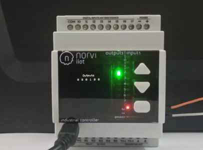

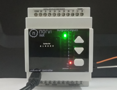

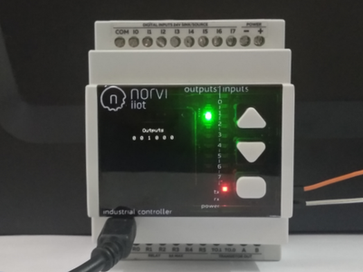

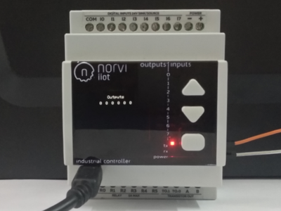

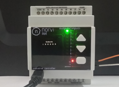

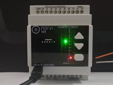

Step 5: Checking the Display
  • Once you upload the sketch and boot up the device you can see that the device is displaying “Outputs” with the 6 respective relay output status. (starting from O1 - O6)
Step 6:
  • Here we have selected the third push-button which gives an ADC range 3290-3310, for our demonstration. (This can be done using any push buttons and for this purpose, the ADC range has to be verified and changed accordingly in the code to make the desired button function.)
  • Once the push button is pressed the first relay output O1 gets turned on and you can toggle the remaining outputs in order by pressing the button again.
  • Apart from the display, you can confirm the toggling by looking at the LED indicators inside the device. Also by using the serial monitor in the Arduino IDE, you can verify the number of times the push button is being pressed.
