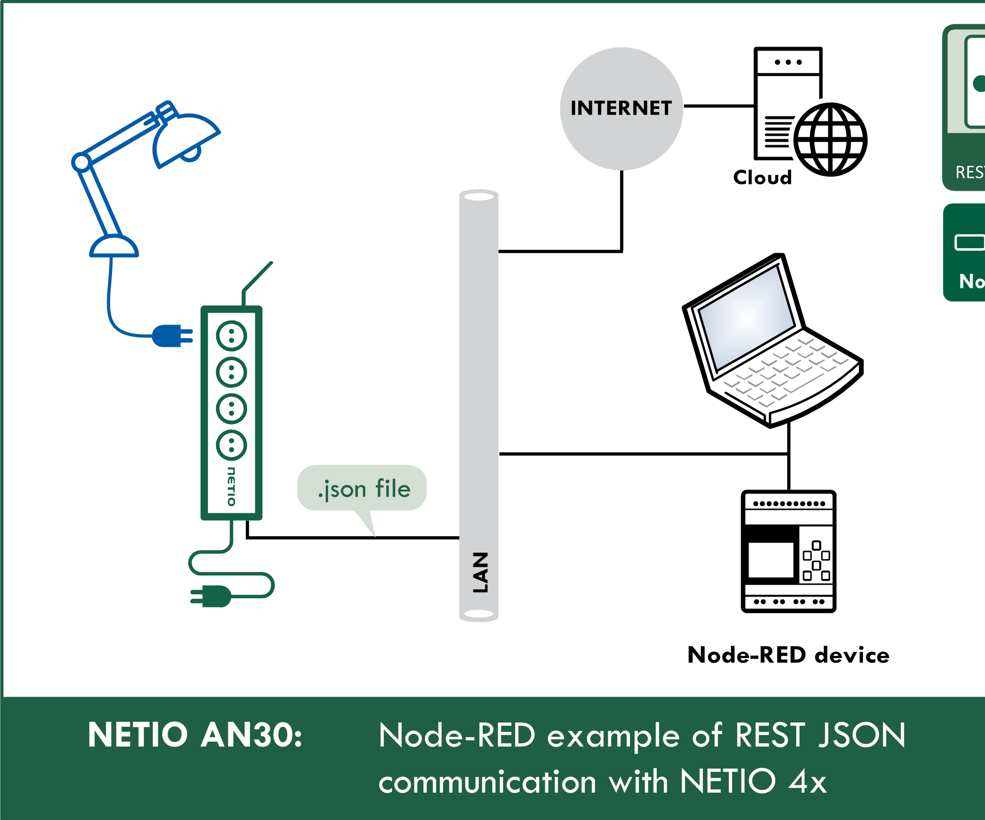

Introduction: Working With URL API in Node-RED
This instructable will teach you how to use URL API (http get) in node-RED. It is intentionally simple. And if you are relatively new to node-RED then this example is right for you. I will teach you how to use node-RED environment and what is, and how to use URL API.
For teaching purposes i will be using NETIO 4All smart power socket, but dont worry NETIO has nice online demo which we will be using so you dont have to buy anything.

Step 8: How It Actually Works
- Five buttons created in the Flow are displayed in the Dashboard.
- After clicking the Output 1 = ON button in the Dashboard, the payload is set to 1(defined in each of the buttons in order to specify the action).
- The Action Selector node selects the string that corresponds to the action(input payload) and creates the resulting URL string for controlling the smart power socket
- The HTTP Request (GET) node concatenates the IP address + the action from the input payload value, and sends the resulting string using HTTP GET Request. The server response(status) is returned as the output.
- msg.payload node displays the response from the HTTP server running in the netio 4All device.
- And Response from server node displays the server response in the Dashboard
