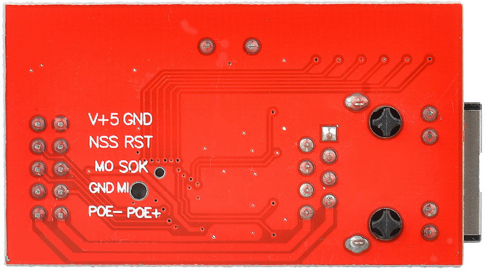

Connecting to your Arduino
The Module has a 2x5 pin header.
- V+ This is a 5 Volt pin
- Ground: There are two
- NSS: This is your 'chip select'. Usually it connects to D10 on the Arduino
- RST: This is your Reset pin. It should not be connected to your Arduino
- MO: This is your MOSI it must connect to the MISO pin of your arduino (D12)
- SOK: This is your Clock pin. It should connect to the SCK pon of your Arduino (D13)
- MI: This is your MISO, it must connect to the MOSI of your Arduino (D11)
- POE - & POE+: These are your PowerOverEthernet pins. However, they are not the standard PoE connection, as they derive from pins 7&8 on your RJ45 jack
Should you think, Well heck, I will just connect that RST pin to my Arduino. Well, no harm done, but you will notice that you cannot upload any sketches

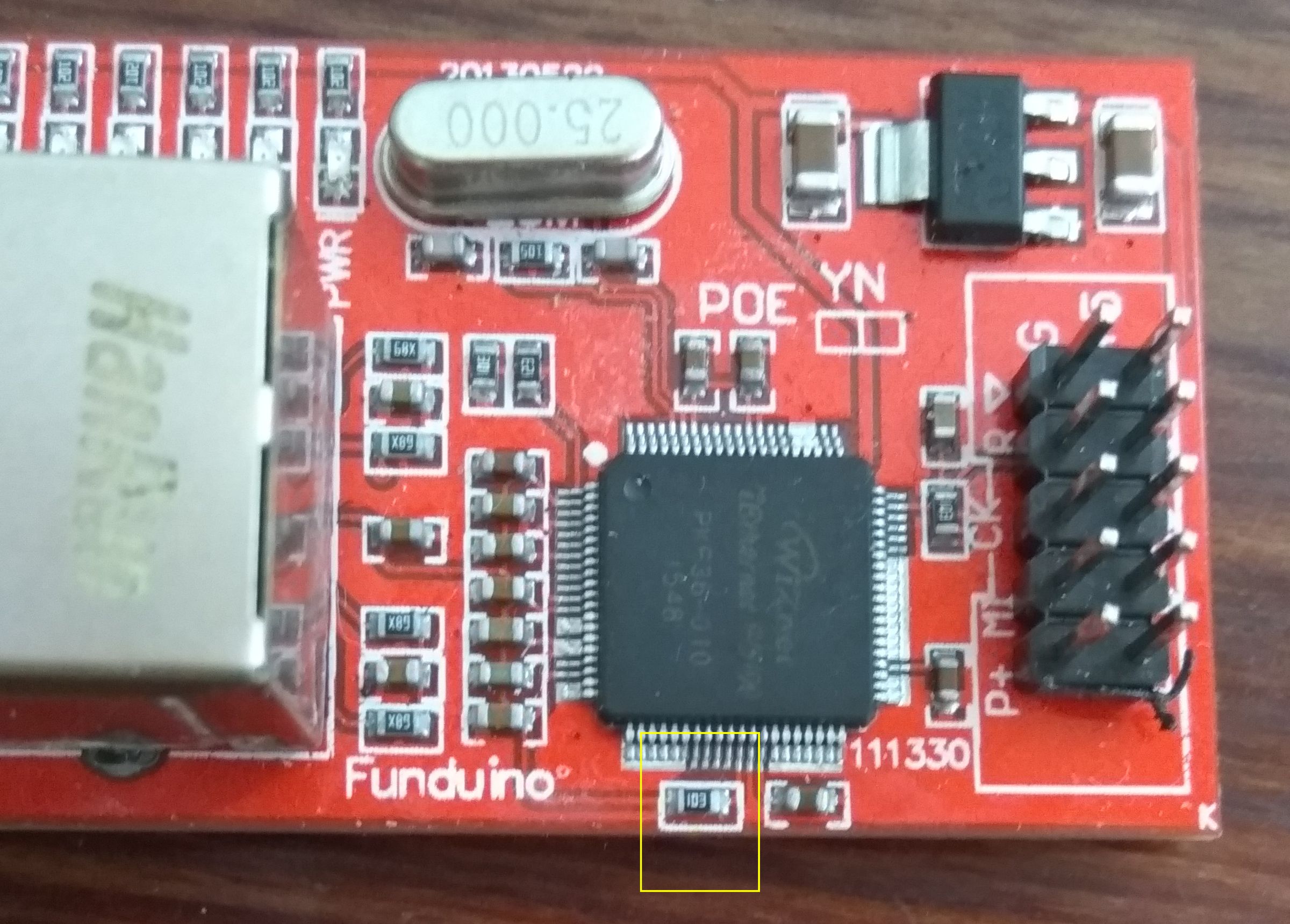

In order for the W5100 to release the SPI bus, it isn't sufficient to just make the ChipSelect HIGH. The W5100 needs a complete disable of the SPI bus. To do that you need to make the SEN (SPI Enable) pin LOW.
The Shield does this with by inverting the CS signal and feeding that to the SEN pin, so when you disengage the active LOW CS pin bij making it HIGH, subsequently the SEN pin will be made LOW which disables the SPI mode.
The Shield uses the 74LCV14 Inverter Schmitt-trigger, but no doubt other inverters such as the 74LVT14 or 74HC(T)14 or CD4011 will do the job as well and probably a 74LC04 or 74LVT04 will be fine too.
Mind you that some of those chips may need 5 Volt rather than 3V3, but both are available on the Funduino board. The problem however is that these chips are 14 pin DIL chips and it is hard to find space for them on the Funduino board. That is why I ordered a 74AHC1G04 as that is only a single inverter chip that measures only 2x3mm and can easily find a place on the module.
So, where to find the SEN pin?
The SEN pin is in fact pin 31 of the W5100. As an 80LQTF chip might not be the most inviting chip to solder on, fortunately there is an easier solution. The pull up resistor that is attached to the SEN pin makes a good entry point for the inverted CS signal. In the above picture it needs to be soldered to the right side of the '103' resistor. The CS signal can be picked up from the NSS pin. The 3V3 signal from the Regulator.
