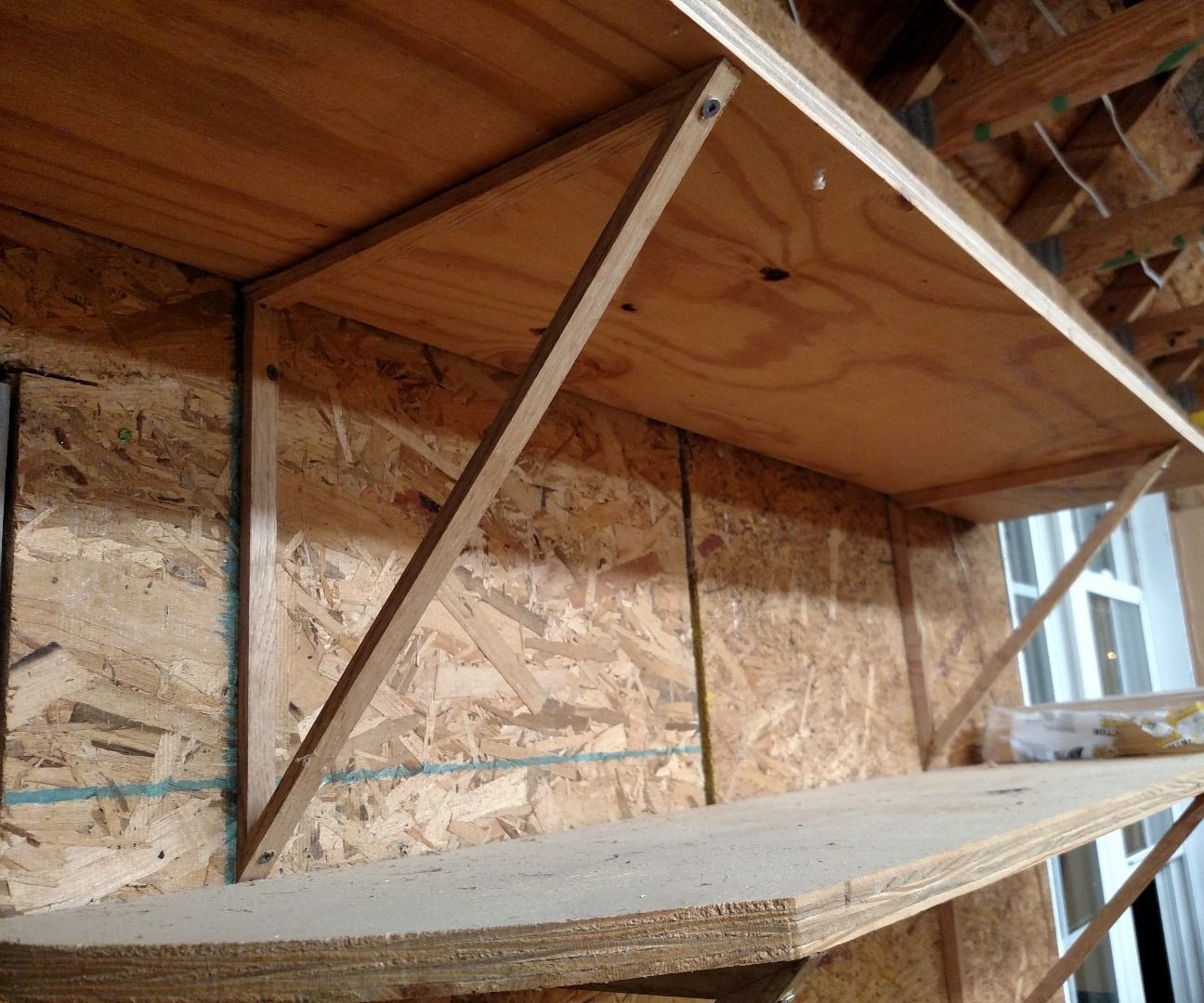

Step 3: Layout
Make them the size you want. Customize the height to the depth and shelve height needed. These are 16" depth on the inside. Keep in mind when determining depth keep it simple to get all out of a single sheet of plyboard. 16", 12" , or 8"
Make sure when you fasten your supports they are square to the posts. Glue the underside and fasten. Repeat.
Step 4: Shelving
The trick here is to go to your favorite home improvement store and find 3/4 plyboard , cheapest possible and have them rip the boards to the width you need. they are very helpful with this and will do it for you without charge. Put two screws into each section to secure.
