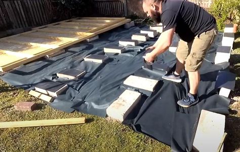

Step 1: The Concrete Blocks.
I am using concrete blocks to support my build no piers.
The reasons for me doing this, is from the front left as you look at it. the blocks could set at ground level, but at the back right it's at least a 2ft drop in the garden level, so require 4-5 blocks.
The other options were to dig out down 2 ft all over (lots of old concrete piers already in the ground so felt it was too much trouble.) or build up a wall to create a concrete slab (huge cost).
The concrete blocks were put on every corner and place where 2 base pieces joined together for a start. and then every joist got its own support in the middle. This is a support every metre or so underneath the whole build.
I concreted everything in and dug about 100mm down for each pier.
using a 3x2 as a marker for height and a spirit level, i took my time levelling everything out.
Step 2: DPM and Weed Suppressant
On top of each block i put a layer of Damp Proof Membrane.
This is a barrier which should help keep the wood dryer underneath and less prone to rot.
I smashed enough weedkiller down to take out pretty much anything, then added a weed suppressing membrane as well.
