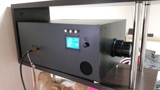

Hi all.
I want to share my newest build: A DIY "real 4k" Beamer.
Here, the 4k means "3840x2160" resolution (called 2160p) upto 60Hz.

Finally, I could get a 10.1" 4k LCD with a proper driving board.
I tried to build my 4k beamer with the LCD, and tested many lenses.
Luckly, the painful experiments were worthy to make this so-satisfactory 4k beamer.

  • You can enjoy 4k contents. The image quality is really really super nice. I will never go back to any FHD beamers.
  • Quite cheaper than commercial 4k beamers! Do the math on the price.
Limitations :
  • The main disadvantage of any kind of DIY beamers is poor brightness. This 4k beamer has brightness similar to most of mini beam projectors. BUT, it is super nice under dark environment. My friends said "wow wow whaooo!!". Technically, there are ways to improve brightness using fly eye lens, PBS, and etc (Thx to Ryan Schmit to let me know these tech.), but this will double (or more than that) the cost and time.
  • HDR is not supported. As it has a hdmi "2.0" port, not "2.0a", you cannot enjoy HDR contents. I've asked Daniel Lee to check whether the port is upgradable or not. I will update any updated news. BTW, many people say HDR is another new sensation. Hope I could feel it in near future.

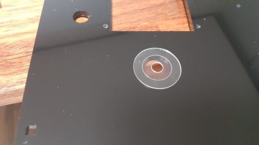

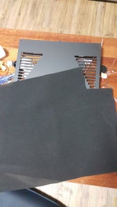

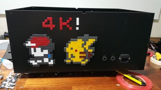

To make it fancy, I made Pikcachu by SCAN mode (you can engrave it easily using laser machine).
Anyway, every 2.5pi holes are the points to make M3 holes. Every parts will be held by M3 (headless) bolts.
Ah! There is an exception. The legs are made by M8 headless bolts and "다보" (do not know English term), and you can change them depending on your taste.
After making every bolt tap, you must glue the housing parts. Assemble them temporarily by taping, and glue them by "chloroform". Due to capillarity, the chloroform soak into the joint edges.
This step can be done easily.

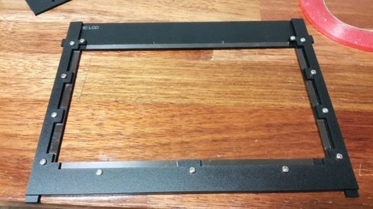

Attach LCD to LCD holder
  1. Assemble the bottom LCD holder and the temporary holding zig. (please make M3 holes in advance)
  2. Attach (is this proper verb?) double-sided tapes as shown in the pic.
  3. Dock LCD to the LCD holder.
  4. Remove the temporary holding zig, and place paper spacers to prevent over pressure on the LCD by the top LCD holder.
  5. Assemble the bottom and top LCD holders together. Do not tighten them so much, or the LCD will be broken. I know cause I did it hahahahahaha()#@$)#@($)!#$.
Then, place this part in a safe place. Prevent dust from it.

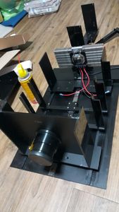

Step 7: Assemble LED Light Engine and Condenser Lens & Make LCD and Fresnel Lens Holder
Time to attach the LED onto the heatpipe.
  1. Mark the positions (on a paper) in where the LED and the condenser lens holder (the lens holder is provided by the seller) will be held by bolts.
  2. Disassemble the aluminium block.
  3. Make drilling guide points using the proper tool (do not know the term, even in Korean) shown in the pic. Without the guide points, it is difficult to drill at exact positions.
  4. Make 2.5pi holes using a drill stand, and make taps into the holes.
  5. Remove old thermal grease, and paste new one.
  6. Attach the LED and the condenser lens holder, then attach the condenser lens. When dealing with any lenses, use nitrile gloves.
  7. The above part is held by the heatpipe holder made by arcryls.

Step 8: Pikachu and Red
This part is not necessary, but it was important part for me.
Yeah, I made Pikcahu and red on the side of my projector. Pixel arts inspired me.
Nothing special, prepare 6 colors, attach it. Just do it. It takes time.
I love my design. Do you?

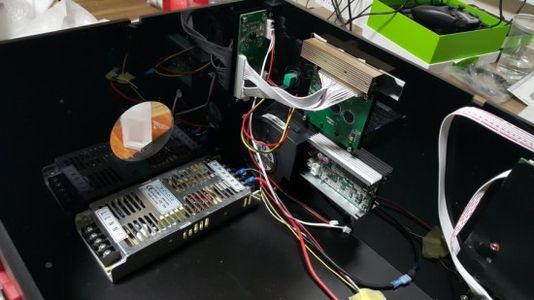

Step 9: Assemble Everything and Do Wiring
Following procedures are rather straight forward. Please refer to the pictures.
Almost done. Place everything in the right position, and do wiring.
Assemble the followings:
  1. Back cooling fans to cool down heatpipe with dust filter x 2
  2. A Blower fan on the side to feed fresh air into the box x 1
  3. LCD cooling fans on the LCD and fresnel lens holder x 8, if you don't have them, someday the LCD will have black spots.
  4. Two push button x2 , one for LED, one for fans and LCD
  5. LED monitoring LCD, it watches LED temperature, running time, and brightness. When the temperature reaches 80 degree C, the circuit will be off automatically for safety.
  6. 220AC plug x 1 to feed power
  7. Fan controller (3 ways) each controlls 1. 2. 3.
  8. LCD board (cut off the BLU inverter)
  9. 240W power supply to feed LED power
  10. 60W power supply to feed LCD and cooling fans
  11. LCD driving baord
The wiring stratages are as follows:
  • 220AC feeds both 240W & 60W power supplies
  • Two main push switches turn on/off 240W and 60W power supplies respectively.
  • 240W is connected to the constant current driver (40A in my memory) first, then it is connected to the LED. When dealing with a high current, be sure whether the wire is thick (check awg numbers) enough to stand the high current.
  • The constant current driver is also connected into the LED monitoring system.
  • 60W is connected to the LCD driving board and 3-ways cooling fan controller
  • The cooling fan controller is connected into 1. back cooling fans, 2. LCD cooling fans, and 3. a blower fan.
The cooling strategy is rather simple:
  • A side blower fan will feed fresh air, and cool down the constant current driver first.
  • The holes on the top covers are the passage for fresh air.
  • Heatpipe cooling fans obviously cool down the heatpipe, and suck the fresh air from the blower fan and from the top cover holes.
  • LCD cooling fans suck the fresh air from the blower fan and cool down the LCD

Step 11: Enjoy
As my cell phone camera is not good, I tried to take the pictures of a PDF file to show you the image qualities.
You can see the image qualities at every position. I should mention that I didn't place my beamer in the right position when testing. Still the quality is super amazing.
As I mentioned, the weakest point is the brightness. Please refer to the pic when the light is turned on. It is not visible. However, it is very satisfactory under dark environment.
I tried to take videos also though the camera quality is not good (last video is test on google play movies, so it is not 4k). Anyway, it is super satisfactory in reality.
In addition, the LCD driving board provides many setting options, brightness, contrast, gamma, hue, saturation, and so on. So, you can calibrate the color space depending on your choice.
I enjoy Netflix in 4k resolution these days thx to my 4k beamer.
I hope this instruction would be helpful to you.
