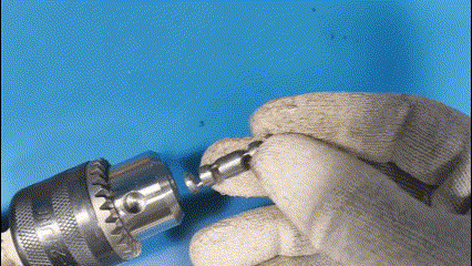

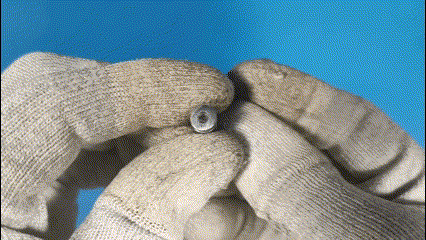

make a centre hole on the crank shaft at corners and attach the nail for holding the crank shaft in the solenoid engine and also for coupling the fly wheel and wiper
  1. Insert the crank shaft into the drill chuck (IMG6.1)
  2. mark centre point with marker (GIF6.3)
  3. drill the hole at both ends (6.4)
  4. Place the nails into the holes use the material the thickness is same as radius of the crank shaft so we can make the nail straight to alignment centre of crank (IMG6.9)
  5. Then soldering them.(IMG6.10)
  6. cut the shaft as require (IMG 6.11), we see clearly in GIF

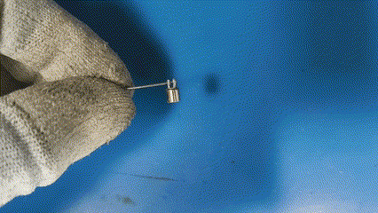

Step 10: Wrist Pin
It is a cylindrical rod that connects the piston (magnet) to the connecting rod in an engine.
Its primary function is to allow the piston to pivot and transmit force to the connecting rod during the engine's operation.
Step 11: Piston (Neodymium Magnet)
Using a neodymium magnet as the piston in your solenoid engine can enhance performance by leveraging its strong magnetic properties. This approach improves the interaction with the solenoid's magnetic field, making the engine more efficient.
Use a cylindrical or cylindrical-shaped neodymium magnet 4*4mm
the Use a cylindrical or disc-shaped neodymium magnet that fits snugly within the solenoid cylinder.
Wrist holder is 3mm*1.5mm*3mm as shown in ( IMG )
make the surface of the magnet as rough for strong bond between the magnet and Wrist holder
stick the wrist holder to the magnet (Piston)
make a hole for inserting the needle to hold the wrist pin on the magnet.
remove the sharp edges to free movement of the wrist pin in the

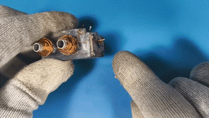

Step 13: Solienoid (coil)
The before wrapping the coil on the solenoid cylinder we must know the
Ensure the solenoid cylinder (core) is clean and smooth.
To Identify TDC in Solenoid Engine (IMG 13.1 &13.2)
  1. Rotate the crankshaft slowly.
  2. Observe the piston's movement within the cylinder.
  3. When the piston reaches its highest point, then identified TDC.
This cylinder forms the core working area where the solenoid interacts with the piston.
after finding mark the either side to the TDC (top dead centre) for the wrapping the copper wire around the cylinder within the marked area. (IMG 13.3)
because under the marked area we have to produce the electromagnetic force to pull the magnet (piston)
If required, wrap a thin layer of insulating tape around the core to prevent short circuits.(IMG13.5)
Now wrap the copper wire around the cylinder within the marked area. (IMG 13.7)
The copper wire is wrapped around 5meters for each solenoid. I dont know the exact turns if we need to know then we have to do calculation
it is a multilayer coil, the number of turns depends on the dimensions of the wire and the core, as well as the number of layers. Here’s a more detailed formula:
N = L/(πx(D+(n-1)xd)) = 5000/(3.141x(4+(10-1)x0.254))
N = 5000/19.744
N = 253.24 = 254 turns
all are mentioned in mm only
Where:
  1. N =is the total number of turns.
  2. L= is the length of the wire. ( 5mtrs = 5000mm)
  3. π= is the constant pi (approximately = 3.14159).
  4. D= is the diameter of the solenoid cylinder. (4mm)
  5. n= is the number of layers. (approximately = 10 layer)
  6. d=is the thickness of the wire. (diameter =0.254mm)
When calculating for multiple layers, you consider the increase in diameter as each layer is added. This formula essentially accounts for the expanding diameter as you lay each additional layer of wire.

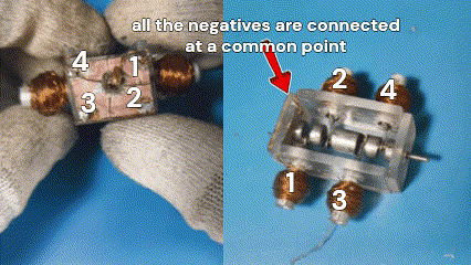

Step 14: Commutator
The commutator component in a solenoid engine, responsible for controlling the timing of current flow to the solenoid coil. This ensures the magnetic field is generated at the precise moment to push or pull the piston, enabling the engine to operate efficiently. the speed is depends on applied voltage and current the minimum is 5 Volts and 2 amps
Rotating Contact Made of conductive materials like copper. Mounted on the crankshaft.
  1. Ensure the PCB has holes for secure attachment to the engine frame.(IMG 14.2)
  2. Design paths for electrical flow to match the commutation.(IMG 14.9)
  3. Add solder pads or terminals for connecting the PCB to the solenoid. The connection is made as shown in the image (IMG 14.10)
  4. Rotate the commutator manually to ensure smooth contact with the PCB pads.(GIF 14.8)
