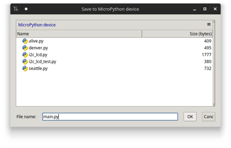

Put this on the Pico as main.py:

Now:
Save as main.py on the Pico.
Unplug and replug USB.
All six LCDs should come up with city/timezone labels on boot.
