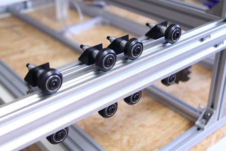

Step 4: X-axis Unit Assembly
First, please assemble solid v wheel unit.
List of Parts
Solid v wheel x4
Bearing x8
Shim for solid v wheel x4
M5*40 hex socket head cap bolt x2
M5*30 hex socket head cap bolt x2
Assembly of solid v wheel
The following parts are required to assemble a solid v wheel. (All of them are included in the parts list above)
1. solid v wheel
2. Bearing*2
3. Shim for solid v wheel
4. M5*40 Hexagon socket head cap screw or M5*30 Low Head bolt
Please push mini bearing into the solid v wheel. Push firmly until the end. This is a state where mini bearing is inserted to one side. Please insert the M5x40 hexagon socket head cap screw from the inserted side of mini bearing. Insert a solid v wheel shim. This shim is used to prevent the mutual interference of two bearings. Insert the solid v wheel. Assembly of solid v wheels is completed. Do the same to assemble four solid v wheels using using M5*40 Hexagon socket head cap screw and M5*30 Low Head bolt.

Step 5: Y-axis Unit Assembly
Assembly of solid v wheel unit
List of parts
Solid v wheel x8
Bearing x16
Shim for solid v wheel x8
M5*50 low head bolt x8
For assembly of solid v wheel unit, please see "X-axis unit assembly"

There is no difference between L and R unit in this Y-axis unit process. We will use “solid v wheel unit” and “Y-axis frame unit“.
Please put solid v wheel unit through the 12mm spacer. Put the 12mm spacer in a hole of Black Angle Corner Connector on Y-axis frame unit. Fix lightly using the nylon nut. Do the same for other three Black Angle Corner Connector.
Adjustment of Y-axis Frame Unit
Please refer to “Reference:Adjustment of V-slot” for adjustment of Y-axis Unit. Pass the 806mm V-slot through the Y-axis unit. Fix the two solid v wheels on the top while making sure that the 806mm V-slot and Y-axis unit are at the same height horizontally. Fix two wheels on the bottom so that they touch the 860mm v-slot. Install it on the V-slot aluminum frame of body. Check again that V-slot and aluminum frame of y-axis unit are at the same height.I f it’s not at the same height or tilting, make adjustments. Check if there is any rattling. Check to make sure it is not tilted. If there is any rattles or tilt, loosen the two slid v wheels on the bottom, place them on the groove of the v-slot and tighten again. Make adjustments until there is not rattles or tilts. Adjust the other set in the same way.

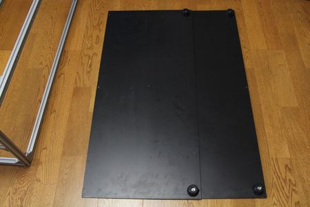

Step 10: Attachment of Cover Bottom
Parts List
Cover bottom x2
Rubber feet x4
M5*20 hex socket head cap bolt x4
M5 T nut x4
M5*6 truss x12
Please make sure of the orientation of the body frame.
Please attach rubber feet to the attachment hole. Fix rubber feet to cover bottom using M5×20 hexagon socket head cap screw and M5 T-nut. Attach rubber feet to 4 places. Attach cover bottom to the body using pre-inserted M5 T-nut and M5×6 truss.

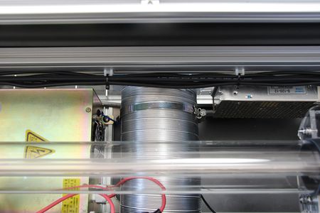

Step 13: Attachment of Laser Power Supply
Parts List
Laser power supply x1
M5*6 truss x3
Use the two aluminum frame to attach the laser power supply. Match the holes of laser power to the aluminum frame assembled in “Assembly of Body Frame (bottom part)“, adjust the position of 170mm aluminum frame and fix in place. Fix laser power supply with M5×6 truss.

Step 16: Wiring of DC Line, AC Line
Wiring of DC Line
Parts List
cable tie, cable tie holders
M3 post-assembly insertion M5- nuts
M3*6 hex socket head cap bolt
carrier mount x-axis/y-axis
X-motor
Y-motor-L
Y-motor-R
laser, power, fan, AC laser, AC-DC, polyurethane tube
Installing Cable Tie Holder
Insert M3 post-assembly nuts to aluminum frame. Fix cable tie holders with M3×6 hexagon socket countersunk bolt. Pass the cable tie through.
Attachment of Cable Tie Holders
Insert cable tie holders to multiple positions on frame.
Wiring of Cable Carrier
Pass the x-motor cable and polyurethane tube through the x-axis cable carrier in advance.Pass the Y-motor-L cable and X1-Limit cable through the y-axis cable carrier on the left side of body.Similarly, pass Y-Motor-R cable and X2-Limit cable through the Y-axis cable carrier on the opposite side. Pass the X-motor cable and polyurethane tube through Y-axis cable carrier on the left side of body.
Wiring of DC Line
Wiring of DC Power Supply
Connect “AC-DC cables”, “FAN cables” and “Power cables” to the DC power supply.
Wiring of Laser Power Supply
Connect “Laser cables” and “AC-Laser cables” to the laser power supply.
More detailed instruction with pictures
AC line Wiring
Terminal Block Wiring
Please connect “AC-Main cables”, “AC-Switch cables”, “AC-Laser cables” and “AC-DC cables” to terminal block.

Step 18: Attachment of Working Bed
Parts List
bed long
bed short
M5*8 hex socket head cap bolt
aluminum frame flat bar
Adjust the position of working bed according to the cutting area
Install the bed long. Connect bed short to bed long and attach. While inserting a few flat bars into the groove, adjust the position and fix opposite side as well. Install the bed frame while keeping the flat bar straight. Fix the bed short. Please insert all of flat bars into the groove.
