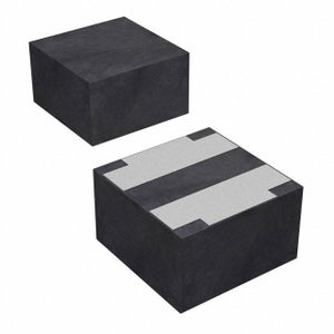

  1. 1µH Inductor (Würth WE-MAPI 4020) ×1
high-efficiency inductor required by the boost converter to step up 3V to 5V smoothly.
