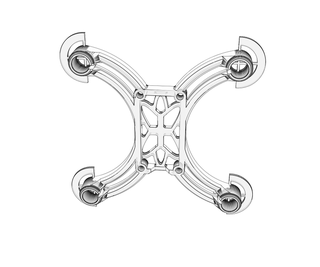

To start, I went on thingiverse and found a 105 quadcopter frame I thought looked pretty cool.
However...I dont have 8.5mm motors!
So I shrunk the frame down in Cura and pressed print on the 3d printer I built!
And... messed up again... The frame was a little bit too tight for the motors, so using a lighter, I warmed up the pla and squeezed the motors into place. But more on that later...
No 3d Printer? Just print using 3d hubs for a cheap and easy way to get the frame without printing it yourself!
(Special thanks to Paintballmagic for creating Beefy Remix Micro 105 FPV Quadcopter)
All I really did, was shrink Paintballmagic's frame from 8.5mm motor mounts to 4mm.
Settings I used:
Height: 0.2 mm
Thickness: 1.0 mm
Fill: 10%
Speed: 50 mm/s
Temp: 210
Printed using 1.75 PLA filament.
Below is the File I used
