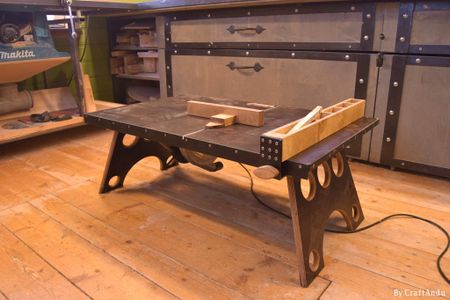

When it comes to woodworking the table saw is is an irreplaceable tool. Rip-cuts, cross-cuts, miter-cuts, bevelled-cuts etc. Of course, all of this could be done with a regular handheld circular saw but a table saw allows you to be more precise.
Now, I do not know if this saw that I built is actually the smallest in the world but I did not see any smaller ones on the internet.

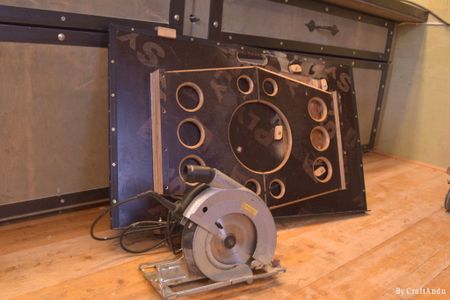

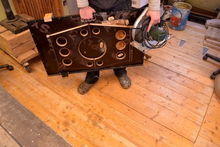

The table has foldable legs which when closed are held in place with small magnets. They have an angle of 15 degrees which in combination with gravity will make the table really stable. It can easily handle my body weight! The setup time is around 30 seconds and when folded together the whole thing can be carried with one hand (saw in the other)

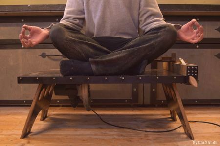

The table can also be used for other purposes such as alternative meditation bench, chair, dining table or workbench.

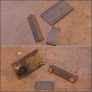

  • L-bar (20x20mm, wall thickness 3mm, length: enough to cover sides and back) This is used to cover the side and back edges to really toughen them and to make sure the plywood can not bend. This is not really needed when using marine plywood but I did it anyway. A big minus is that it adds quite a bit of weight. As a hindsight, I would say that the L-bar on the sides is not really necessary as it will not add any strength to the structure (just some weight). The back one is absolutely necessary when you plan on adding a miter track ( 1cm cutout in 2cm material will make it really brittle.
  • Flat bar (width: 40mm, thickness: 4mm, length: width of the table). This is used to cover the front edge of the table and is also part of the rip fence mechanism. I will explain it later.

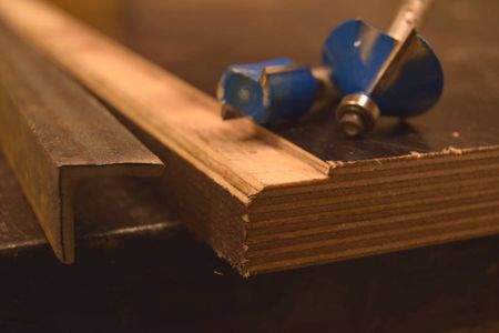

  • Router a groove for the L-bar on sides and back
  • Inside corner of the L-bar is not exactly a corner - it is quite round. Chamfer the edge to accommodate that.

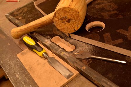

  • Drill a series of holes with a spade bit near one edge (back) to make a handle, smoothen it with a chisel and roundover bit.

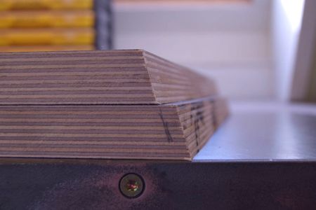

  • Carefully measure and cut the legs to size. First, cut the 15-degree bevels on a table saw and then set up a stop block on crosscut sled to cut the 15 degree angles on the sides.

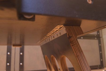

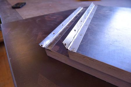

  • Rout a groove for piano hinge (double check before you do so)
  • Drill holes with hole saw. These holes will make the construction just a bit lighter and they can be used to clamp the table to a firm surface. Later on, I also added a row of holes - It was mainly because one clip (for attaching the circular saw) was right under one leg. To make it symmetrical I decided to cut holes in both legs.
  • Round over the sharp edges with router and/or roundover plane
  • Cut the piano hinge to size and attach it to the legs.
  • Measure and attach the legs! I later on doubled the amount of screws that were holding the hinges. This made it really stiff!

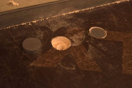

  • Drill a small hole in the leg, push a small nail in there and close the leg to transfer the hole to the table. Take out the nail and drill a bigger hole for button magnet. Attach the button magnets with hot glue or epoxy. Repeat the process until the legs stay closed when carrying the table (It was 4 pairs for me)

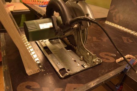

  • Measure and align the saw. Reference from the flat bar on the front as you want the saw to be perpendicular to that.
  • Bear in mind that the saw has to clear the leg even if it is at its full cut capacity. I messed it up the first time. No worries, I cut a thin strip of plywood and glued it to the hole made by first plunge cut. On the second cut, I made sure that the motor unit cleared the leg.
  • Fix it temporarily in place with screws.
  • Plunge cut!
  • After that mark where the saw is with a marker and rout a cavity around 1 cm deep. I did this only so that I could cut 2x4-s on the table saw (It added 1cm to my cut height) This is of course not mandatory.

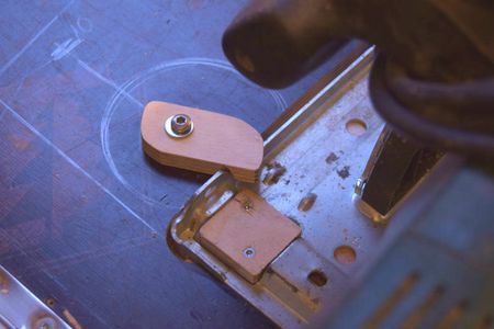

  • Now comes the tricky part of fixing the saw securely to the table. Of course, screws could be used for this but it requires a cordless drill and is overall more time-consuming. I decided to make 4 clips that easily secure the circular saw in place. They are made out of plywood, pan-head screws and washers. I think that pictures (and video) explain it pretty well. Tighten the screws by hand so that they are fairly tight but still turnable by hand. You should aim for at least four clips in every corner, but every saw is different (mine is pretty bulky).
  • I routed the cavity just a bit to big for so the saw so ended up adding two plywood blocks that would further fix the saw in place.

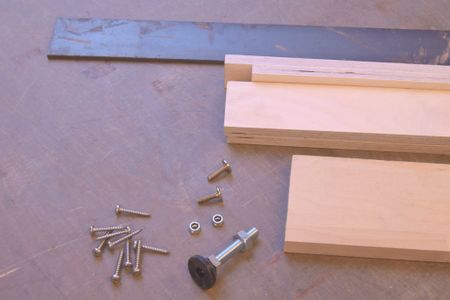

You will need:
  • Plywood
  • Pan-head screws
  • 2 furniture bolts and 2 lock nuts
  • Adjustable furniture leg and a single bolt
  • A piece of flat bar (I used 6mm thick, 60mm wide, around 15 cm long)
  • Small piece of L-bar from earlier
  • Some wood for the knob
  • Epoxy
  • Paint and oil
Tools: Welding machine, chop saw /metal band saw, drill press, cordless drill, brand nailer, wood glue, tap set
  • Start by cutting strips of plywood for the fence. I made my fence 60mm wide and 80mm tall.
  • Make a long box by glueing and nailing the pieces together (see pictures)
  • Add small pieces in the middle to strengthen the structure. I left the first slot intentionally bigger as it will hold pencils.
  • Cut the metal to size and tap the holes for furniture leg and two bolts. This piece could technically also be made out of wood but it would have to be thicker and bulkier (and no nearly as strong)
  • Weld the metal parts together as shown in the pictures. Be sure to add the furniture leg in before you do that!

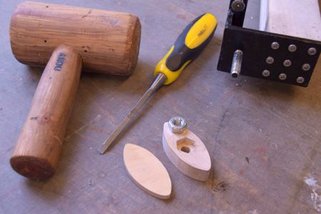

  • Make a small knob and epoxy it in place
  • Attach the metal part to the wooden "box" you made earlier

Step 7: The End
That´s it - the saw is ready!
As you can see the saw is pretty strong! I was actually quite surprised myself that when I stood or sat on the table, it did not show any sign of breaking.
Check out the video if you did not see it already!
Of course, you have to bear ion mind that this saw is not for fine woodworking. The circular saw that I used hat quite a lot of play in its trunnions/hinges. I do not think that other handheld circular saws are much better. This table saw is merely for rough construction work!
It is super easy to transport this thing! It stays compact until you give it a nudge and the legs open. You attach the saw, plug it in and add the guide and you are ready to go! It all takes just around 30 seconds to set up!
