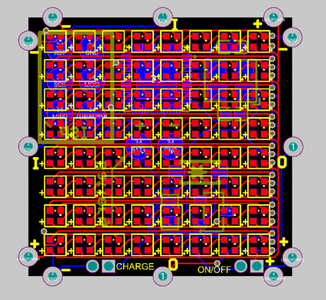

Step 2: Designing and Manufacturing the PCB
With the schematic complete, it was time to move on to the PCB layout. The goal was to fit 384 tiny 1x1mm WS2812B LEDs onto an 8 cubic centimeter cube, so space optimization was key. Using Altium Designer, I carefully placed the components and routed the traces to ensure smooth data and power flow across the entire LED array.
PCB Design:
- I created a 2-layer PCB to accommodate the high density of components while keeping the board compact.
- To ensure reliable connections, I routed ground plane separately from the signal traces, reducing electrical noise.
- The ATmega328p microcontroller was placed at the center, allowing short signal traces to all LED arrays.
- I also added mounting pads for a 1.27mm pitch header to allow easy reprogramming and power connection.

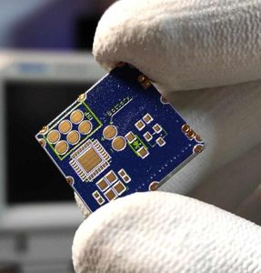

Manufacturing:
Once the PCB design was finalized, I uploaded the Gerber files to JLCPCB, who handled the manufacturing. Their precision fabrication and affordable prices made them an excellent choice for a small, complex project like this.
After receiving the boards, I performed a quick inspection to ensure the traces and solder mask were clean and accurate. Everything looked perfect, so I was ready to move on to assembling the components.

Step 3: Soldering the LEDs and Components
For this project, I used a hot plate to reflow the solder paste and attach the LEDs and components. These 1x1mm WS2812B LEDs are incredibly small, so using the stencil was essential for applying solder paste evenly.
Here’s a detailed guide on handling these tiny components and ensuring a solid connection:
- Use fine-tipped tweezers for placing LEDs.
- A microscope will help with inspecting your solder joints.
- A flux remover will help clean up any excess solder and ensure clean connections.
If you prefer soldering by hand, then you can only solder the bottom side components, as for the LEDs it is not possible to solder them by hand.
