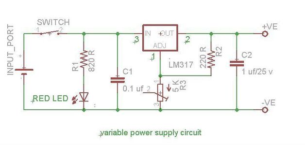

The main problem faced by the electronics engineers are they want a variable power supply for testing their circuits.the cost of the variable power supply is nearer to $5.here I am going to make the variable power supply in the range of 0-12V .this instructable costs less than $1.

Resistor -220R[1]
-820R[1]
Resistor -5K(potentiometer type ) [1]
Capacitor -1 uf /25v[1]
-0.1uf[1]
LED -red [1]
IC -LM 317[1]

Take the common pcb board and mark required size with the help of marker and cut it out.
Assemble the circuit with proper planning&make the solder.
place the soldering leg where the external parts are connected.

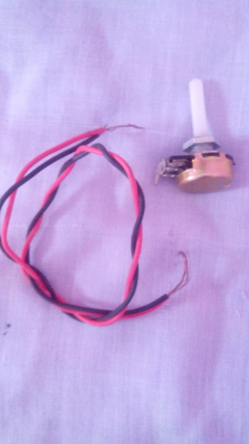

Take the potentiometer and solder the wire in pin 1 and pin 2.
Connect to the potentiometer with the pcb board.
