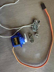

Electronics & Mechanics
These components power the interactive lighting and movement in the installation.
  1. Microcontroller:
  2. Adafruit Trinket M0 (or compatible microcontroller with Arduino IDE)
  3. Sensors & Outputs:
  4. VL53L0X Time-of-Flight Distance Sensors
  5. NeoPixel Mini Button PCB LEDs (individually addressable RGB)
  6. Micro servo motors (for flower blooming mechanism)
  7. Hardware & Mechanics:
  8. Brass rods (for mechanical flower)
  9. Brass tubing (for mechanical flower's actuation)

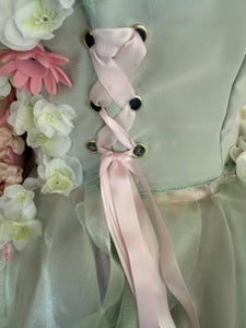

I chose not to use interfacing or lining to keep the garment light and flowing — anything too rigid would’ve distracted from the soft, organic feel.
Bodice Construction

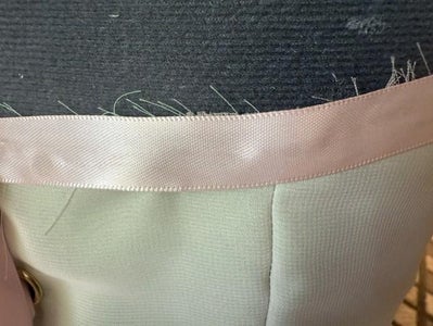

  1. I took measurements from the display mannequin and drafted a corset-style bodice to match with a muslin fabric as a draft before translating that draft to my final fabrics.
  2. The base layer of the bodice was teal crepe, layered with pink chiffon on top for softness and translucence.
  3. Grommets were installed at the back to create a corset closure using a light pink chiffon ribbon laced in a crisscross pattern.
  4. I finished the edges of the bodice with the same ribbon for a cohesive and complete look.

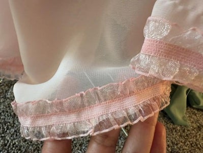

Skirt Construction
  1. I started the skirt by draping fabric directly onto the mannequin to build a flowing shape with natural movement.
  2. The base consisted of green chiffon under a layer of pink chiffon.
  3. On top of this, I added overlapping petal-like panels of green and pink organza to evoke the shape and layering of lotus petals.
  4. The pink chiffon layer was edged with a pink ruffle ribbon to prevent fraying and add visual texture.
  5. The green chiffon layer was hemmed with a clean folded edge, and the organza petals were carefully singed to seal the raw edges without bulk.

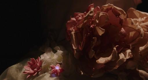

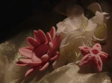

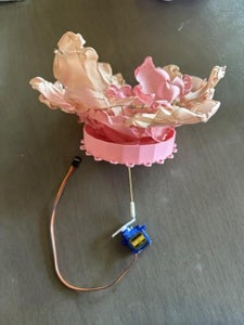

Step 3: Mechanical Flower Construction
I built seven mechanical flowers for the dress—three mounted at the shoulder and four around the waist. These flowers are not just decorative; they respond to audience interaction by blooming and wilting based on proximity. The closer someone is to the garment, the more the petals open. As they move away, the flowers slowly close back up. This motion is powered by individual servo motors controlled by distance sensors, which will be covered in more detail in the Electronics section.
To build the flowers, I shaped thin brass rods and tubing to create the petal mechanism, then soldered the joints for durability. The petals were made from light and dark pink polyester fabric, cut into varied organic shapes. I singed the edges to prevent fraying and add a soft, natural finish. I then glued them to the brass petals with jewelry glue.
The design was inspired by the Ever-Blooming Mechanical Tulip by jiripraus (link), though my version omits LEDs, petal veining, and a flowerpot base. Since these were part of a wearable installation, I adapted the structure for horizontal mounting.
To keep the flowers upright—especially with the added fabric weight—I designed and 3D printed supports for each stem, which then fed through pre-installed grommets on the dress. Because this was a prototype and not fully designed for wearability on a person, I mounted the servo motors and the electronic components inside the mannequin rather than on the dress itself. Inside the mannequin, I mounted each servo motor on wooden scaffolding. Holes were drilled through the installed grommets using a Dremel to align the flower stems with the internal servo arms. As the servo moves, it pulls or pushes the stem, opening or closing the petals accordingly.
Although troubleshooting each flower took time—especially in terms of wire routing and consistent mechanical motion—all seven flowers ultimately functioned as intended, creating an immersive and interactive floral experience.

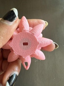

Step 4: 3D Modeling & Printing

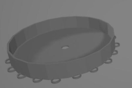

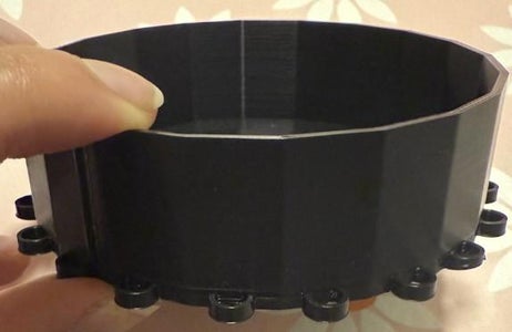

Custom 3D printed components played a crucial role in both the structural and aesthetic elements of this wearable installation. All models were created using Tinker CAD and SketchUp and printed in PLA using Prusa and Bambu printers. Pink PLA was used for visible components, while clear PLA created a diffused lighting effect in the skirt.
Mechanical Flower Supports
To stabilize the weight of the mechanical flowers—especially with added fabric petals—short cylindrical supports were designed with a hole for the stem to pass through with built-in sew tabs for secure garment attachment. These kept each flower upright and prevented drooping.
Sensor Mounts
Each mechanical flower is paired with a VL53L0X time-of-flight sensor to measure proximity. To house and conceal the sensors, a modified lotus flower model was used, designed to accommodate the sensor’s emitter and receiver. These were printed in pink PLA and hot-glued near each flower.

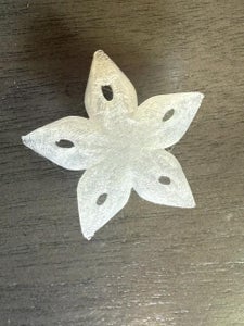

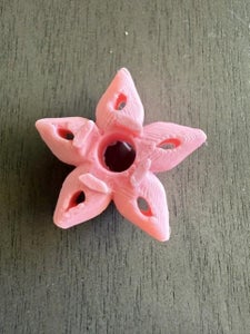

LED Mounts
Two styles of 3D printed flower mounts were used for LED integration:
  1. Near mechanical flowers: A resized and adjusted flower model held individual LEDs in place. These pink PLA mounts were hot-glued close to the flowers for a localized lighting effect.
  2. In the skirt: The same flower model was enlarged, flattened, and filled in to diffuse light. Printed in clear PLA, these mounts created a soft glow and were fitted with resized tabs to secure the LEDs.
Design Process
There was some trial and error to get dimensions and fit just right—especially for snugly holding electronics—but once finalized, the printing process was fast and easily repeatable.

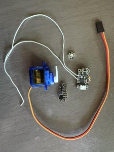

Step 5: Electronics & Power
This installation uses nine Adafruit Trinket M0 microcontrollers—seven for the mechanical flowers and two for the LED string lights in the skirt. Each is powered by its own rechargeable battery and connected to a toggle switch for easy control.
The mechanical flowers are powered by 4000 mAh batteries housed inside the mannequin. Due to their weight, these required careful mounting to prevent strain on wires and solder joints. Each flower’s Trinket M0 controls a servo motor (connected to a digital pin), a VL53L0X time-of-flight sensor (connected via I²C), and a NeoPixel RGB LED (connected to a digital pin). The sensor detects a person’s distance, triggering the flower to bloom or wilt, while the LED brightens with prolonged interaction.
For the skirt LEDs, I used four strands of NeoPixel RGB LEDs per microcontroller, with two LEDs in series per strand, totaling eight LEDs per microcontroller and sixteen LEDs overall. These are powered by 3.7V, 2000 mAh batteries stored in stitched pockets. Each strand is assigned to its own digital pin, and the LEDs are programmed to twinkle in green, pink, and white—matching the garment’s palette.
To house the electronics, I widened parts of the mannequin and drilled holes aligned with grommets to run wires inside. A wooden scaffolding inside supported the servo motors and held components in place. I closed the mannequin back up once all of the mounting inside was complete. All wiring was hand-soldered—no breadboards or custom PCBs were used. While I burned out a few boards early on, I improved with practice.
In the future, I’d explore smaller battery packs for easier concealment and consider a more powerful microcontroller to reduce the number of separate boards and batteries.
