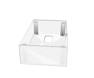

Step 3: 3D Print Your Casing
Using the .stl files provided, print both the top and bottom (labeled "Projecttop" and "Boxbase" respectively) to have a case ready to assemble.

Step 6: Holding It Down
Here we need to make sure that the arduino, motor driver, and touch pad are safely installed so using the holes provided on the bottom case screw in both the arduino and motor driver using 1/4" screws.
- The arduino is positioned on one of the walls while the motor driver belongs in the holes positioned on the bottom
- Feed the touchpad wires through the remaining holes on the wall of the box so that the touch pad is connected on the outside while the wires remain on the inside
- Lastly place the airsoft inside the cutout of the box where it should be a snug fit
