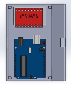

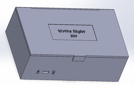

Step 2: Design and 3D Print the Box
Start with measuring the Arduino, battery, mini PBC board, and switch. Using these measurements, you'll be able to create the box that's perfect for your needs.
Using CAD software like SolidWorks, design a basic box that will securely house the Arduino board, PCB, and other electronic components, based on the size of the parts you choose. Opt for a small design, to make carrying the product more comfortable. The design should include built-in openings for the switch, LED, and a slot for the pressure sensor wire to exit and attach to the pen.
Our box consists of a middle lid as well, that hides all of the components and only leaves the LED exposed. If you want to build that as well, design support bars on the inner corners of the box to hold it up. The middle lid should include an opening for the light and small handles for easier removal.
The STL files for our specific design are attached for immediate print, as well as the files that can be viewed directly in Solid.
Box Sizes For Basic Design
The box itself is 130mm in width and 80mm in length on the outer part. It has 3mm thick walls that are 50mm high.
The lid is 130mm in width and 77mm in length and 3mm thick.
The additional middle lid is 121mm in width and 71mm in length.
Pring Settings
All 3D printed parts were printed with a layer height of 0.2 mm and the default infill rate (around 15-20%), and the filament used was PLA. The colors we had available were yellow and pink. Additionally, if the supplies are available, the top lid can be made transparent, making the light visible without having to open the box.

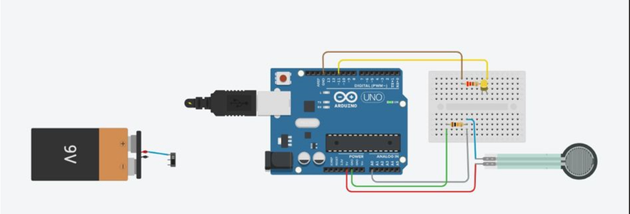

Step 3: Assemble the Circuit on Soldering Board
Place the Arduino UNO on a soldering board and connect the force sensor, LED, resistors, and switch according to the circuit diagram, and these steps:
  1. Place the breadboard next to the Arduino for easy wiring.
  2. Insert the 220 ohm resistor on the breadboard. One end of the resistor end will be grounded, and connected to the Arduino's GND port (brown wire).
  3. Place the LED on the board- the negative side will be on the same column as the second end of the resistor.
  4. Connect the positive side of the LED to the 11th port of the Arduino (yellow wire).
  5. Place the 10k resistor on the other side of the breadboard. Ground one end to another GND port on the Arduino (green wire), and the other to the A0 port of it (gray wire).
  6. Connect the pressure sensor. Connect one side to the 5V port on the Arduino (red wire), and the other on the same column as the resistor and its connection to the A0 port (blue wire). Use an extension if needed.
  7. Connect the 9V battery to a DC barrel jack connector.
  8. Plug the barrel jack into the power port of the Arduino Uno to provide external power to the board.
  9. Use two additional wires to connect the switch to the battery.
Double-check all connections to ensure they are secure and correct before proceeding to the next step.

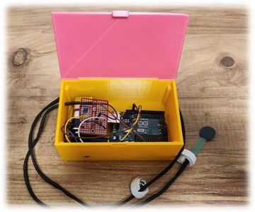

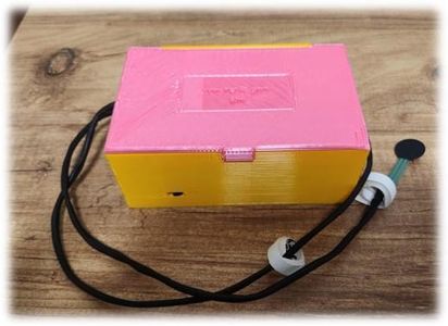

Step 7: Final Assembly
The Box
Place the Arduino, PCB, and other components into the 3D-printed box. Secure the components using screws or adhesive if necessary. Attach the switch to its designated slot and ensure the pressure sensor wire exits the box smoothly and is long enough to attach to the pen.

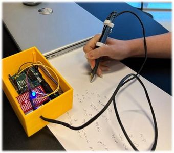

The Pen
Wrap the wire connected to the pressure sensor around the pen using Velcro straps. Position the sensor where the user's fingers typically press on the pen, ensuring it is securely attached and can accurately detect pressure.
Step 8: Write and Enjoy Pain-Free Writing
Now that your WriteRight device is fully assembled and tested, use it during your writing sessions. Enjoy the comfort of writing without worrying about wrist pain, as the device will alert you when you applytoo much pressure, encouraging healthier writing habits.
