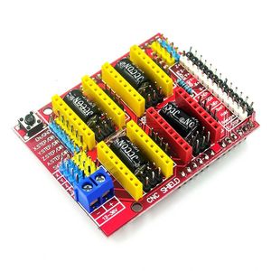

- CNC Shield V3 Expansion board (1 pc)

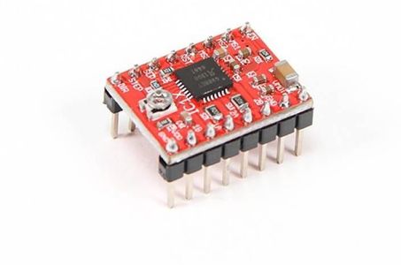

- A4988 Stepper Motor Driver (2 pcs)

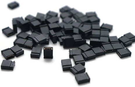

- 2 pin Short Jumper ( 6 pcs )

To build the controller, you'll need an Arduino Uno, a CNC Shield V3 Expansion board, two A4988 Stepper Motor Drivers, and six short jumpers.
As shown in the picture, install the CNC Shield V3 Expansion board to the Arduino Uno. Next, attach a short jumper to the CNC shield as indicated by the diagram. As seen, insert the last two A4988 drivers into the CNC shield.
