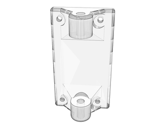

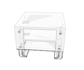

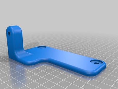

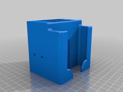

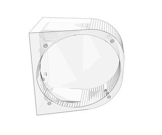

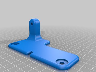

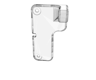

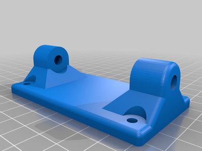

Step 1: 3D Print the Phone Holder/ Panel Support
Download the files and 3D print them... They are already set in correct size.

Use Sugru or hot glue to connect panel supports to the solar panel. And the two holders to the stick. DO NOT glue the cover on!
Use bolts and nuts to connect the cover to the phone housing. I drilled a hole on the cover for the USB wire so it will fit better.

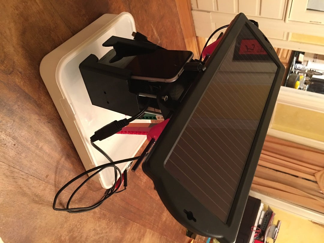

Step 4: Lego!
Depends on the weight and size of the solar panel, it need support from behind. This is just an example of my design, which is able to twirl and allow the panel adjust to different angles. You can also change the degrees of the panel by simply adding or removing lego pieces. And of course, colors are all by your choice! Be creative!
