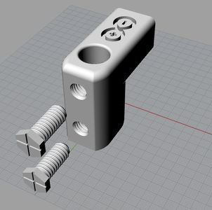

Earlier I showed how the X-Axis was arranged, I swapped out the servo for a little stepper motor. I have linked to the one I bought, a "5V 28BYJ-48". Do not bother with one like this, they are so so slow and as a result printing takes much longer, you have to wait at least two seconds for the stepper to raise the pen by 1mm clear of the paper. This is down to the fact that I have an interesting gear ratio going on with my floppy driver worm gear as much as the stepper motor but anyway, I would recommend using a superior stepper motor or just redesign the way I have set the Z-Axis up.
Anyway, the penholder. I designed a pen holder in Rhinoceros 5 that I 3D printed and glued to the floppy drive component, I have included a .3dm file should you wish to edit the design in Rhino or another software of your choice and I have also included a .stl file ready for 3D printing.
