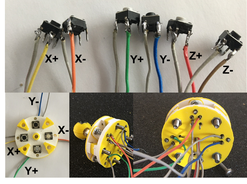

Step 1: Connecting the Coloured Electrical Wires
The mounting starts by connecting the coloured electrical wires to the 6 mini push button switches. Yellow wire for [X+]; Orange wire for [X-]; Green wire for [Y+]; Blue wire for [Y-]; Red wire for [Z+]; Brown wire for [Z-]. The grey wire is commonly used to power the button presses, either through Ground or Vcc, depending on the final application and associated electronic assembly. This colourful assembly simplified the visualisation of the connections after the final assembly of the joystick :

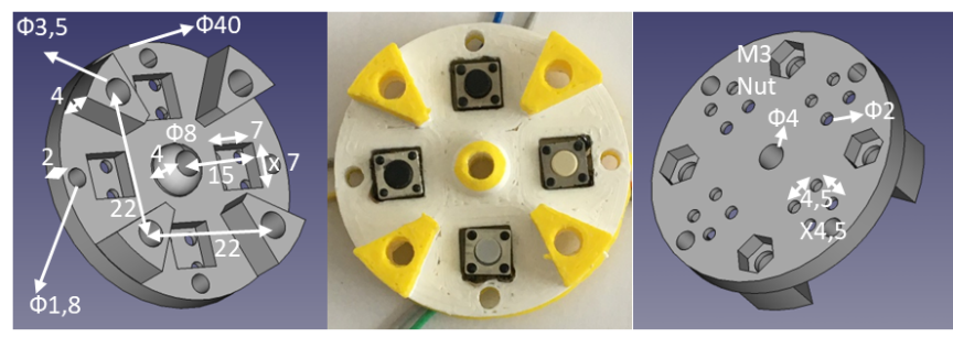

Step 2: The Base
The base mainly houses the mini push button switches and M3 nuts, which secure the final assembly. It features a 40 mm diameter and 2 mm thickness disc, with four 7 mm square compartments located 15 mm from the center. These last compartments hold the push buttons that measure 6.5 mm on each side. The central points of these switches are located approximately 12mm from the centre of the base part. Each square has four 2mm diameter through holes for positioning the pins and wires of the push button. Additionally, four 1.8mm diameter holes for the spring axes, required for the reversible movements, are located behind the push button housings. Four 4mm spacers enable the top base to be adjusted to the required distance for unrestricted movement along the X and Y axes. Each spacer has a 3.5mm diameter through hole for the placement of an M3 screw, which secures the assembly with a nut housed in a dedicated housing on the back of the base part.

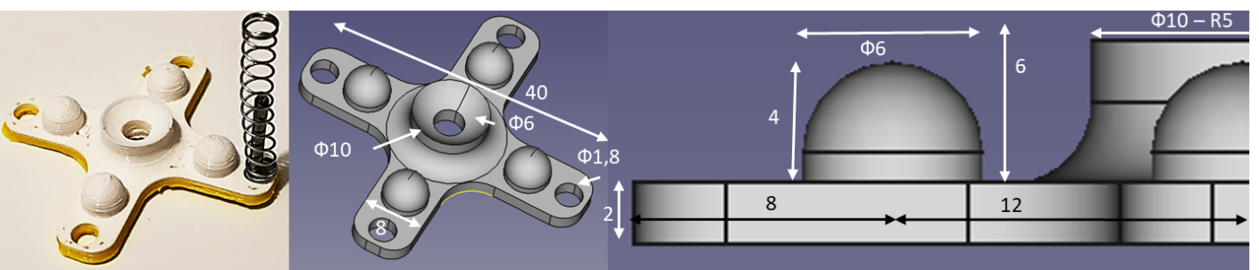

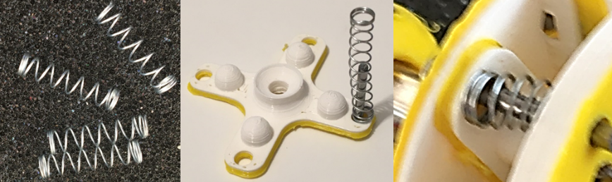

Step 3: The Mobile Plate
The half-spherical ball joint of the mobile plate is centered on the base part. The half-spherical ball has an 8mm diameter. The center features a 4mm through-hole that is used for wiring [Z+] and [Z-] as well as the common power supply. The function of the moving plate part is to press the switch buttons. It achieves this through 4 hemispheres with 6 mm diameters placed over the switches, positioned precisely 12 mm from the center. These hemispheres are situated 8 mm from the end of a 40 mm-long, 5 mm-wide, and 2 mm-thick branch. The ball joint housing is situated at the centre of the component. The cylindrical housing measures 10mm in diameter and 6mm in height, with a central cavity of 6mm diameter for the ball joint. A 4mm hole runs through the centre of the component to enable the [Z+][Z-] wires and the common power supply wires to pass through.
Four holes, each measuring 1.8mm diameter, allow the spring axes to be positioned. The four springs provide reversible mobility by relying on the mobile plate on one side and the base on the other.

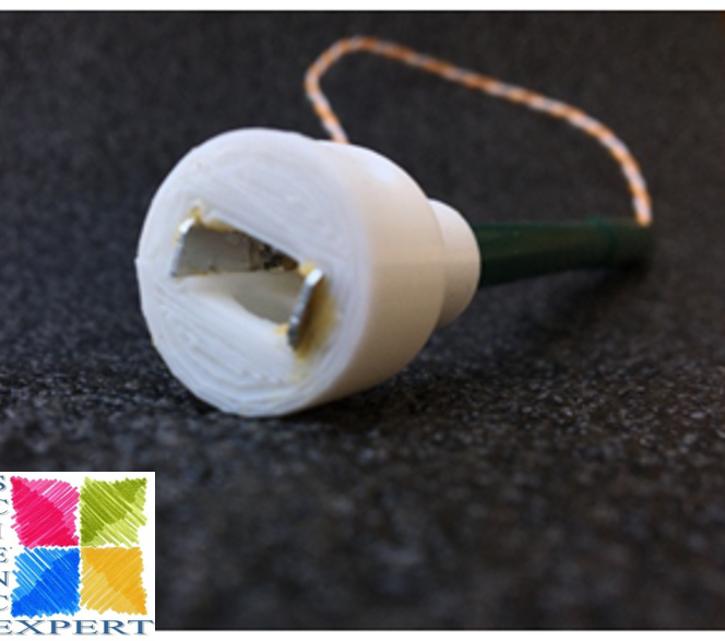

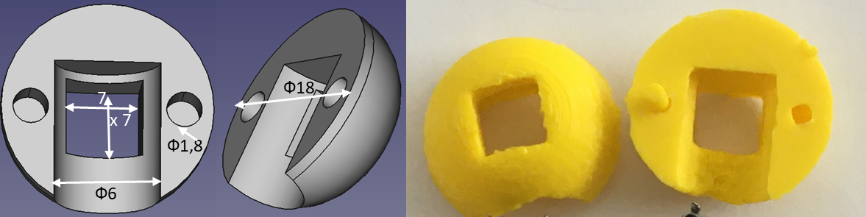

Step 5: The [Z+][Z-] Rod Head
The joystick's end section is the rod [Z+][Z-] head, which contains the two buttons for displacement along these axes. This spherical head is made up of two half-spheres of 10 mm diameter with cubic cavities of 7 x 7 mm² for the push-buttons. One cavity is used to secure the axis, which is the pen's tube with a diameter of 6 mm.
Two 1.8mm diameter holes enable you to insert a piece of 3D printing PLA wire to simplify assembly of the sphere. Start by securing the PLA rods into the holes, then insert the buttons into their respective cavities. Finally, bond the entire assembly around the pen's tube with cyanoacrylate glue (super glue).

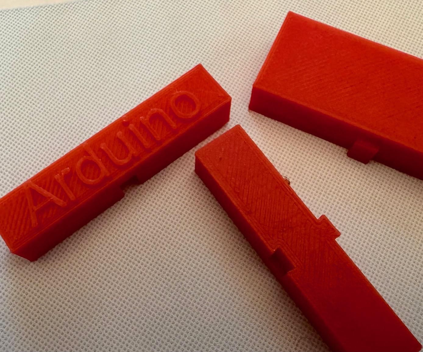

The assembly is mounted using M3 screws and nuts and cyanoacrylate adhesive. If required, a final box and suitable 7 connectors can be added to complete the assembly.
Editor's note : Two colours (white and yellow) of PLA were utilised in this equipment merely for photographic and contrast purposes.
