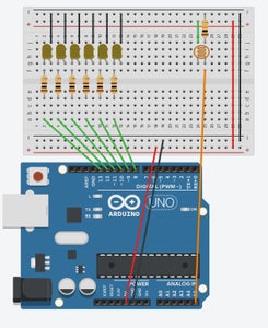

The following layout was used to make the prototype in order to simulate the radiation dose intensity detector. The prototype consists of 1x Arduino Uno, Arduino wires, 6x white LEDs, 1x LDR, 6x 100 ohm resistors and 1x 10k ohm resistor.

Troubleshooting:
  • Did you build the circuit correctly?
  • No leds placed the wrong way around?
  • Ground and 5V port in correct position in breadborad?
  • All resistors are correctly plugged in?
  • Reupload the code to your Arduino.
