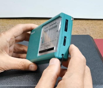

It is immediately noticeable that the radio, at least for now, is solidly made externally. On the front side there is a speaker, AM and FM scale, Power LED and Band switch.
Both scales are clear with precisely printed readable font. The switch has 12 positions for selecting Band and moves easily with an audible click at each new position. Two dials are placed on the side, one for tuning and the other smaller for volume control.
On the top side there is an On-OFF switch, a headphone jack, as well as an external 5-volt power supply. Also on the side there is a large telescopic antenna with a length of 55 cm for better reception.
On the back there is a bracket for support and a space for batteries. The device works with two 1.5 Volt AA batteries, and this is perhaps the only small complaint, because for a price slightly lower than the 20 dollars total this receiver costs, it could have contained a lithium battery.
In general, at least externally, the radio is made in a retro style with mechanical dials and switches, and finally the power supply is in the same style, with standard batteries. Otherwise, I am a big fan and supporter of this style.
