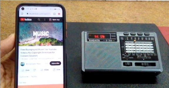

Step 2: MP3 + Bluetooth Speaker
 When the mode switch is in the middle position, if we have inserted a micro-SD card, the MP3 player is automatically activated, which is seen on the left 7-segment display. Use the buttons to select the desired song. Also, instead of an SD card, we can use a USB drive to listen to mp3 music.
 If we dont have an SD card inserted, in the middle position of the Mode switch, Bluetooth speaker is selected. Now we need to connect to the bluetooth device with the Smartphone without a password and the audio content from the smartphone can be heard on the radio.
  A few words about the sound, I think it is quite enough for the purpose for which the device is intended, and it is clear without audible distortions up to 90 percent of the maximum. It is noticeable that it reproduces the low frequencies quite well considering the dimensions of the speaker.
