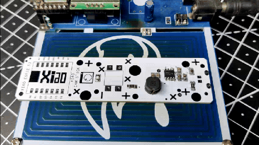

Step 2: PCB Design
The PCB Design for this project is a straightforward setup based on two primary sections: the power module section, which includes an IP5303 PM IC that boosts 3.7V of Li-ion Cell to 5V for any USB Device to work, in this case an XIAO Module, and the XIAO Breakout board, which essentially keeps XIAO in its place.
When the button is pressed, the power module starts to function and powers the XIAO Board. The power module output is connected to the XIAO's 5V and GND.
After the schematic is finished, we build the PCB file. First, we create a 95mm x 25mm outline and position the XIAO on top. We next add the power management IC setup to the lower region, and the lithium battery holder is placed on the bottom side.

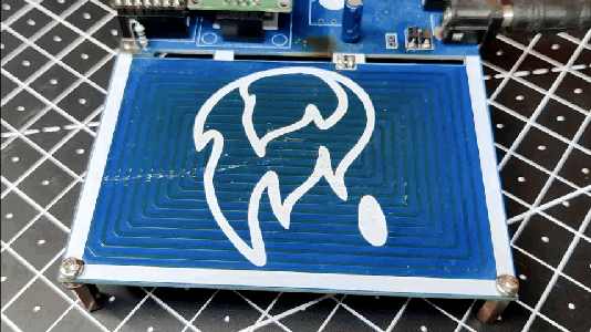

Step 3: Seeed Fusion Service
The final PCB was sent to SEEED Studio for samples.
An order was placed for a White solder mask with Black silkscreen, and the PCBs arrived in less than a week, which was super fast.
The quality was very good considering the price, which was also pretty low.
Seeed Fusion one-stop shop offers one-stop prototyping for PCB manufacture and PCB assembly, and as a result, they produce superior quality PCBs and Fast Turnkey PCBA within 7 working days.
Seeed Studio Fusion PCB Assembly Service takes care of the entire fabrication process, from PCB manufacturing and parts sourcing to assembly and testing services, so you can be sure they are getting a quality product.
After gauging market interest and verifying a working prototype, Seeed Propagate Service can help you bring the product to market with professional guidance and a strong network of connections.

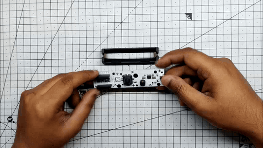

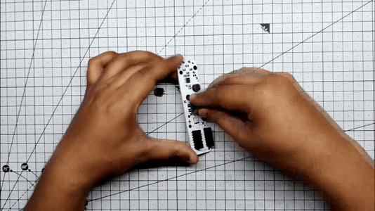

Step 4: PCB Assembly Process
This project's PCB assembly process consists of two major steps: first, we add SMD components, and then we place THT components.
  • We begin by applying solder paste to each component pad individually using a solder paste dispensing syringe.
  • Next, we pick and place all the components in their proper places using ESD tweezers.
  • Following the pick and place process, we place this board on a mini reflow hotplate, which heats the PCB from the bottom up to the solder paste melting temperature.

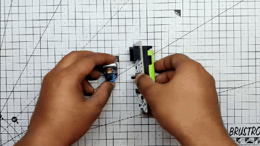

  • Then we put all of the THT components in their proper places, such as the header pins in the XIAO pads, the USB Port, and the switch.
  • Finally, using a standard soldering iron, we attach the Lithium Cell Holder to the bottom side of the board, completing the assembly of the board.

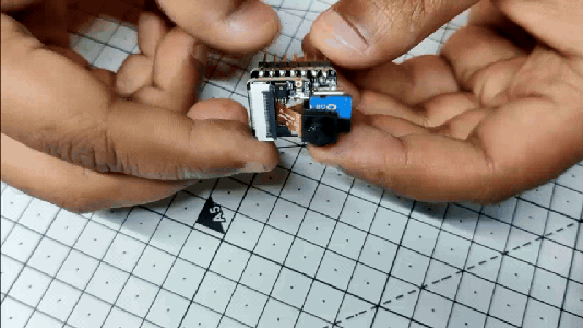

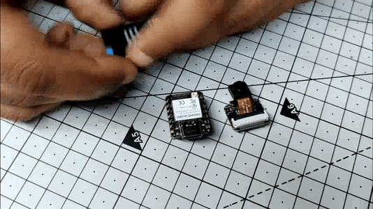

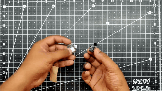

Step 5: Setting Up ESP32 S3 Sense
To place the XIAO Module on the circuit, header pins must be added to the pads before using it with the Sensing Module.
  • We use a breadboard to keep the xiao and header pin in place permanently after adding two CON7 Male header pins along both sides of the XIAO.
  • The SD Card is next prepared by being plugged into a PC and formatted in FAT32. This step is essential since an SD Card won't function if it hasn't been formatted in FAT32.
  • After formatting, we attach the sense module to the XIAO Board using the male and female B2B Connectors before sliding the SD Card into the SD Card slot on the sense module.
You can check out this wiki guide about using XIAO and the Sense module by clicking the link below. Seeed Studio has created a well-documented page with an elaborate starting guide and sample sketches.

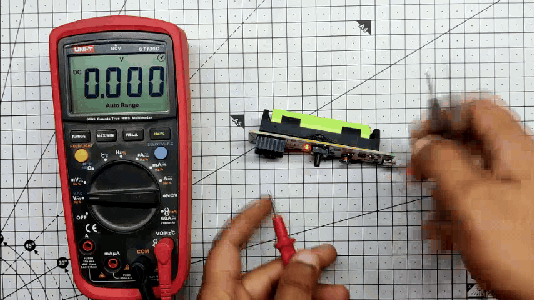

Step 6: Power Source
A 3.7V 18650 Li-ion cell with a capacity of 2200 mAh, or 8.14 Wh, is used as the power supply, and it is enough to power the typically low-powered XIAO ESP32 S3 with sense module.
After correctly orienting the Li-ion cell in its holder, we press the switch to turn on the Power management IC. The device goes OFF when the switch is double-tapped.
Power management IC output is measured with a multimeter and is found to be 5.1 volts, indicating that the setup is working and that we can move on to the next phase.

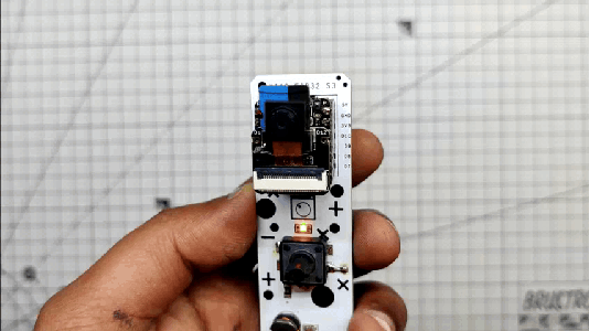

This project is now complete after the code was uploaded to the XIAO Board and placed in its proper location on the circuit.
The power management configuration is turned ON and XIAO receives 5V when the main button is pressed.
It will take a picture and save it to the SD card once every 10,000 milliseconds
Step 9: Result
So here's the final result of this project: a working Handy Point-and-Shoot camera made completely from scratch.
By turning ON this setup, XIAO clicks an Image and waits for a minute, then retakes an image again and saves them all on the SD Card.
The image quality is not the best, but it's pretty great considering the price and how well it can be used in many potential projects.
Overall, this project was successful. The next step is to take this device on vacation somewhere, take pictures, and test this concept in the real world.
