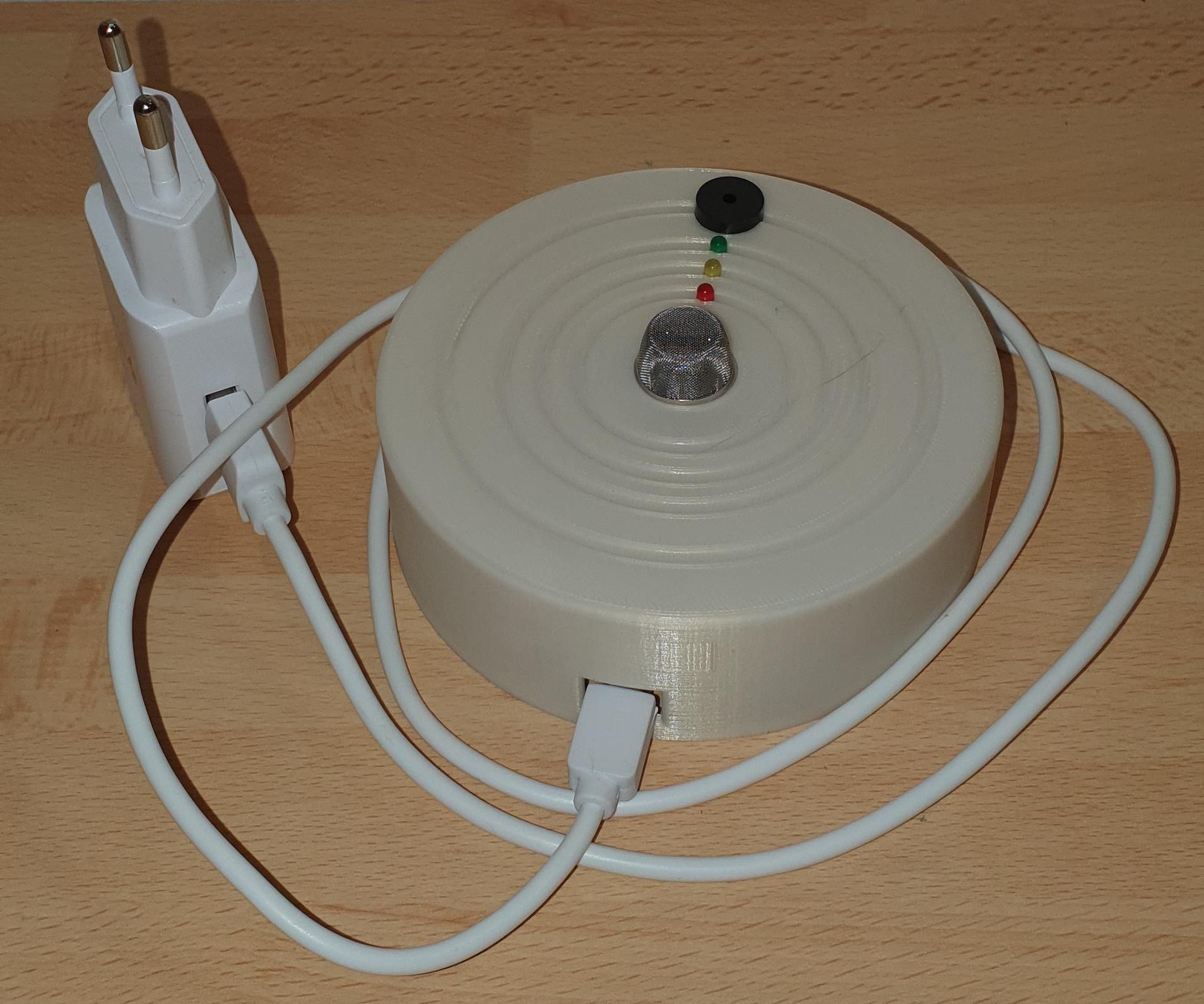

Then once all mounted I started to construct a controler using ESP8266, based on the schematic above.
The piece of code with 3 simple effects, and wifi connection with a feature of receiving the correct time can be found here. You might ask why wifi or time is needed, the code is prepared to trigger effects at a given time e.g. at full o'clock, or at midnight, any minute, based on you imagination. The code in this example switches the effect every minute keeping it for 30 second to demonstrate the time feature.
Either you can use Arduino IDE or any other IDE that suits you the best and play with the code or you can just easily upload the bin file located in the same github folder using ESP tools.
