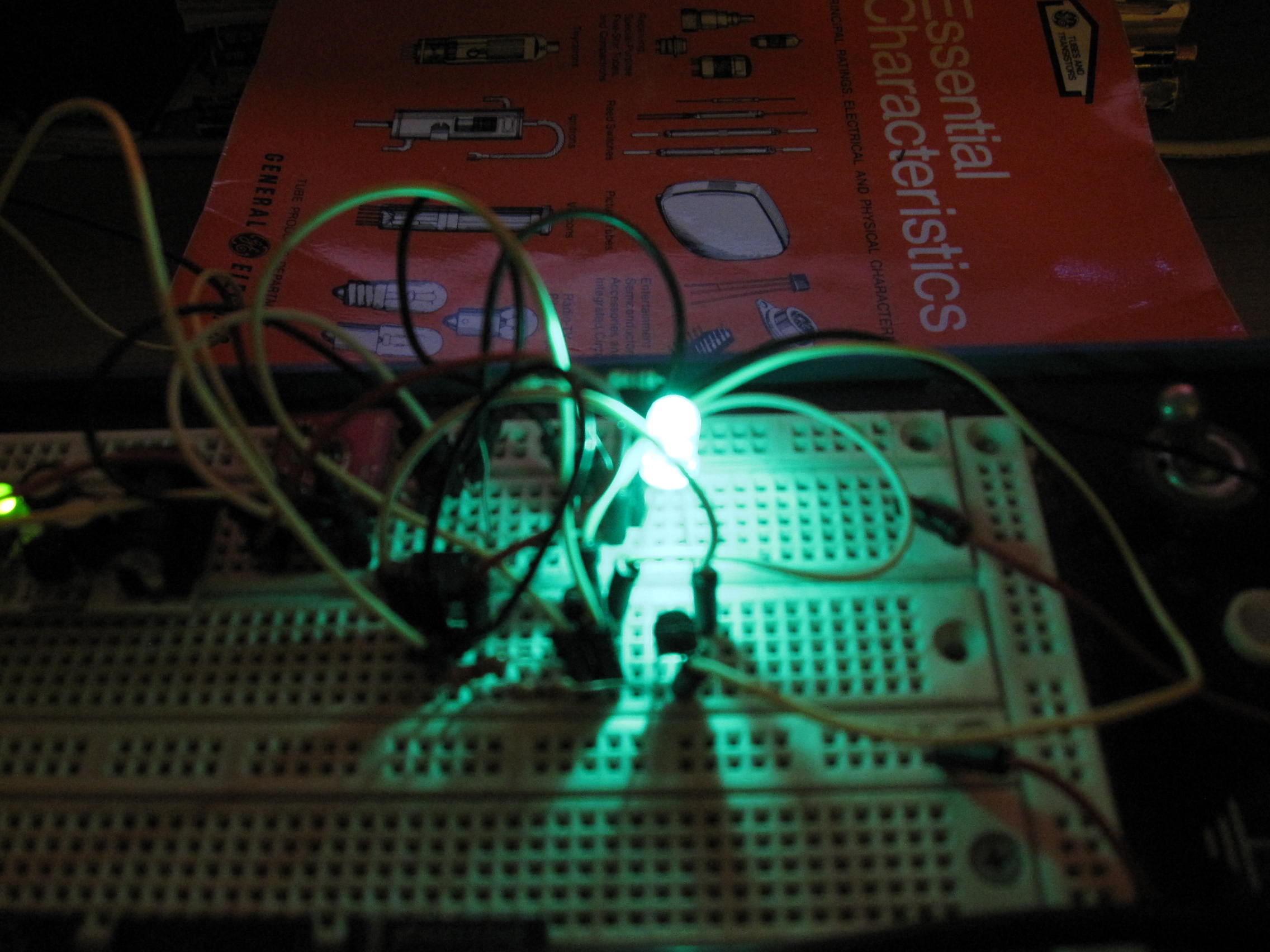

I built the project on a small piece of prototyping board with copper pads for through-hole parts. Using sockets for the ICs helps a lot for programming/modification/testing; the USBTiny ISP from Sparkfun has a similar socket on its board so programming the two chips just consists of plugging the programmer into a PC USB port, uploading the transpiled XOD code from the included Arduino .ino files with the appropriate board and programmer settings, and then gently removing the chips from the programmer socket and inserting them into the protoboard sockets.
The Pololu TPS6120 based boost converter module comes on a riser board soldered into the protoboard on pin headers, so it's possible to save space by mounting some components underneath. On my prototype I put the two 4.7k pullup resistors underneath. These are required for the i2c bus between the chips to operate correctly - communication won't work right without them! On the right hand side of the board is the input jack for the solar panel's plug and the input storage capacitor. It's best to try to connect the jack and this cap directly together via "runs" of solder, not hookup wire, to get as low resistance a path as possible. Runs of solid solder are then used to connect the positive terminal of the storage capacitor directly to the input voltage terminal of the boost module, and the boost module's ground pin directly to the jack's ground pin.
To the right and left of the sockets for the two ATTinys are 0.1uF despike/deglitching capacitors. These components are also important not to leave out, and should be connected to the ICs power and ground pins through as short and direct a path as possible. The 10 ohm current sense resistor is at the left, this is connected in line with the output from the boost converter and each side is connected to a sensor core input pin - these pins are set up to work as a differential ADC to indirectly measure the current into the battery. Connections between IC pins for the i2c bus and to the boost converter shutdown pin, etc. can be made using hookup wire on the underside of the protoboard, very thin solid-core hookup wire works great for this. It makes changes easier and also looks a lot neater than running jumpers between holes on the top.
The LED module I used was a tri-color RGB unit, my plan was to have all three LEDs active to produce white when the battery was nearly fully charged, and slowly fade the blue LED out into yellow as charge was depleted. But this feature has yet to be implemented. A single white LED with one current-limiting resistor will work OK, too.

Next thing to check is that i2c communicaton is working OK, with the board running off bench power the sensor core IC can be installed. On an oscilloscope there should be pulsing signals on both pin 5 and pin 7 of the physical chip, this i2c driver on the chip attempting to send data to its buddy. After shutting down the driver core can be installed and the connection checked with an oscilloscope again, there should be a larger sequence of pulses visibile on both lines. This means that the chips are communicating correctly.
It helps to have the battery slightly charged for the final full test. The bench supply can also be used to accomplish this, with the current limit set to about 50 mA and the voltage still at 3.8 volts, leaving the LiPo battery connected directly for a few minutes.
The final step is to test out the full system - with everything connected up if the panel is covered for ten or 15 seconds the light should come on being driven via the driver core's PWM output. With the panel in bright sunlight, the battery should charge from the boost converter's output. The fuzzy logic network can be indirectly inspected to see if it's working correctly by looking at the PWM line driving the boost converter's shutdown pin; as illumination increases with battery with low state of charge the pulse width should increase, showing that as more power becomes available from sunlight, the driver core is signalling that more power shoud be sent into the battery!
