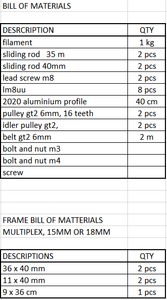

here list of materials and list materials for frames. With the attached bill of materials, a 3D printer has been successfully built with a printing area of 20 x 20 cm with a height of 20 cm.

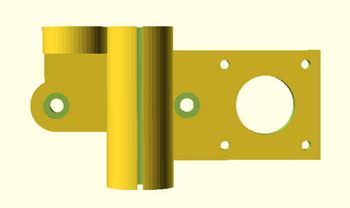

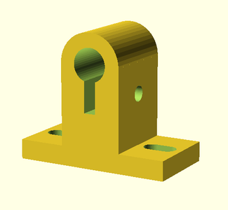

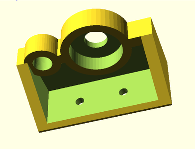

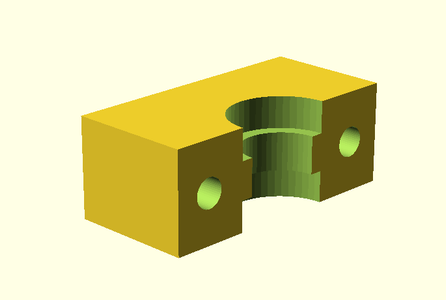

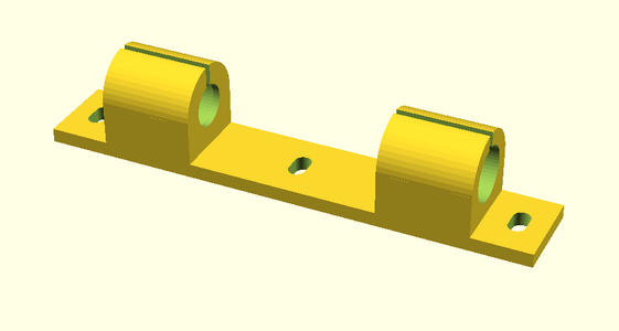

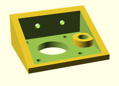

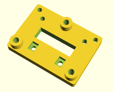

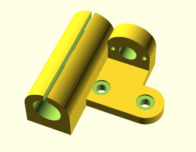

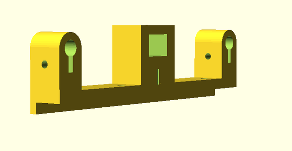

for parts that require precision, for example the part that holds the bearing, you can modify the design using the attached openscad file which is then rendered and converted into an .stl file. Here also file .stl in attachment. if needed , feel free to asked for scad file.
