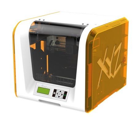

Introduction: XYZ Da Vinci Junior (jr) NFC Tag Filament Reset Hack
This process will allow you to reset your filament nfc tag to a full configuration using an Android Device with NFC. If you don't have an NFC enabled Android Device or what something different I have an Instructable using an Arduino and NFC Attachment that can be found at this link:
