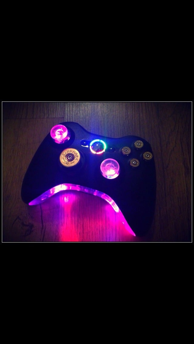

I'm sure you guys have seen numerous amounts of modded xbox 360 controllers but here is my interpretation of some. Hopefully with this instructable you will be able to mod your own controller to how you like. Unfortunately at the time of typing this I actually have a broken wrist so I have tried to use pictures from the past I have took when modding. I would've liked to do a full step by step guide and enter the gamer comp but by the time I heal the deadline will have probably passed. Oh well here it goes. If you like this please vote for me. Thanks and enjoy!

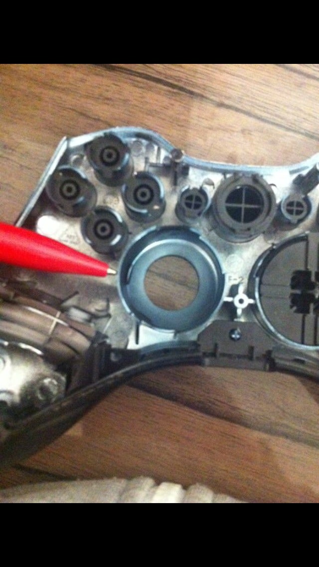

You will then need to open up the shell and drill where the thumbsticks go. Again nice and easy. Once happy then glue the loom into place.

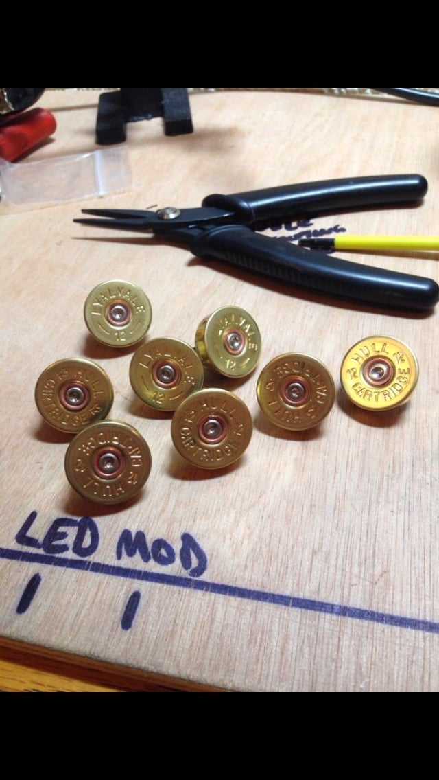

Now this bit I find really fun. Turning a spent shotgun cartridge into a cool looking D-pad. I shoot quite a lot so can get my hands on hundreds of these things which is handy. Firstly make sure the cartridges are empty. Sounds stupid but what you are about to do next would be dangerous with a live round. You need to heat the brass shell for about 10-20 seconds to warm up the plastic then quickly separate the plastic from the brass. Use two sets of pliers for this. Once separated set the brass to one side to cool. Next you need to trim the original d-pad so it fits inside the brass shell. Once it fits glue it into place and Roberts your fathers brother! Easy.

So there are all types of LEDs available on the internet so have fun with the colours. Also mix it up with the buttons. I have created many modded controllers and came up with lots of different styles over my time modding using bullet abxy buttons and colour-changing LEDs.
Also try making a theme for your controllers. This would help you decide on a style. Check out a few of the examples shown and have fun making them.
